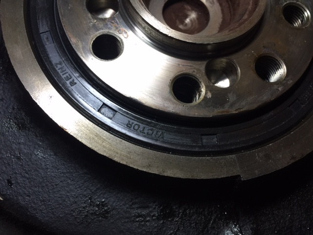

I'm in the middle of replacing my fly wheel and I just replaced the main seal. It's sitting a couple of mm inset on one section. Is that ok. What I'm saying is that when I replaced it and was tapping it in, it isn't flush in a couple of spots and sits in a little. The seal isn't damaged but I wanted to be sure before I bolted everything up.

Pictures if it helps. You can see that the left side of the seal is flush where as the right side of the seal is set back a little.

You need to make sure it seats flush with the cylinder block. Here is a new one installed (ignore the green arrow). Image is from our clutch DIY. Getting the seal started around the crankshaft can be a bit tricky. Make sure that the lip is oriented correctly.

So if it's sitting in from the cylinder block a tiny bit means I need a new seal and I need to try again huh?

Get a new one. It sucks, but not as much as oil leaking onto your clutch later.

I agree. It looks like you hit the end of the crankshaft. It also looks like the bottom of the seal is in too far in the first pic. You may need to start over with a new seal. Carefully drive the seal in or, you can cautiously tap the seal in one section at a time in small increments. Use an extension to tap on the seal instead of the hammer itself, use the extension like a drift, hit the end of the extension with the hammer. The idea here is to install the seal with out cocking it inside the gap. Try to work it in evenly. Take your time and make sure it seats flush with the cylinder block.

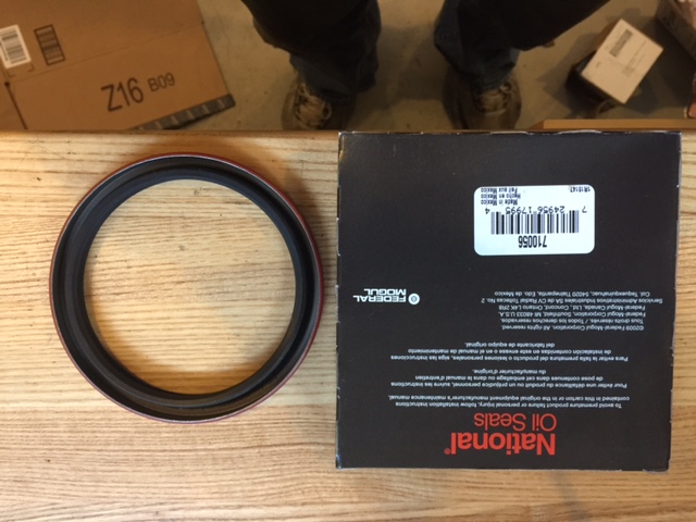

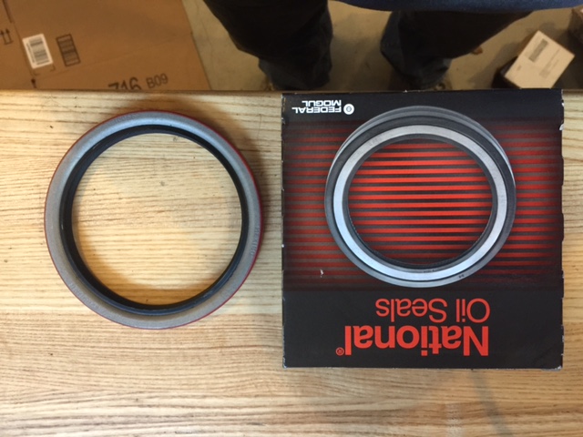

UPDATE: So I went shopping this morning. There are in fact O'Reily's in CT so that was an interesting find.
I followed the advice in the modmini video and grabbed the National Oil Seal 710056 seal as it looked like he was having a much easier time than me in the video. All of the auto stores' websites claim this doesn't fit our application but modmini insists it does and after fitting it he is right.
Turns out all the major auto supply stores carry 1 (and only 1) of these in stock to include Autozone, Advance Auto Parts and O'Reily's. I guess Napa doesn't carry them though.
I had a MUCH easier time with this seal than the Victor Reinz one and highly recommend it. I've included pictures of the part if anyone is interested. I'm not an expert on seals by any means but this part just feels better in the hand than the Victor Reinz one.
Thanks guys!
