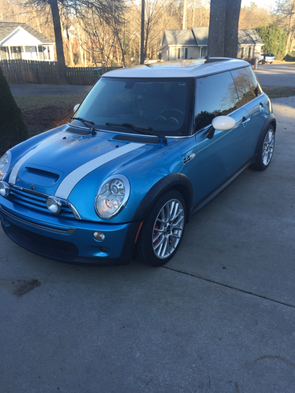

The mini

Posts: 36,759
Likes: 2,548
Nice electric blue with challenge wheels. Very nice. Looks like brembo brakes up front. Chrono pack or nav ?
Old Jan 13, 2016 | 03:53 PM
Nc_r53's Avatar
Nc_r53
Joined: Jan 2016
Posts: 8
It has the Nav with blue carpet and blue/black seats
Old Jan 14, 2016 | 05:15 AM
Posts: 36,759
Likes: 2,548
Nice , it has the lapis blue interior then. Very rare to see anymore
