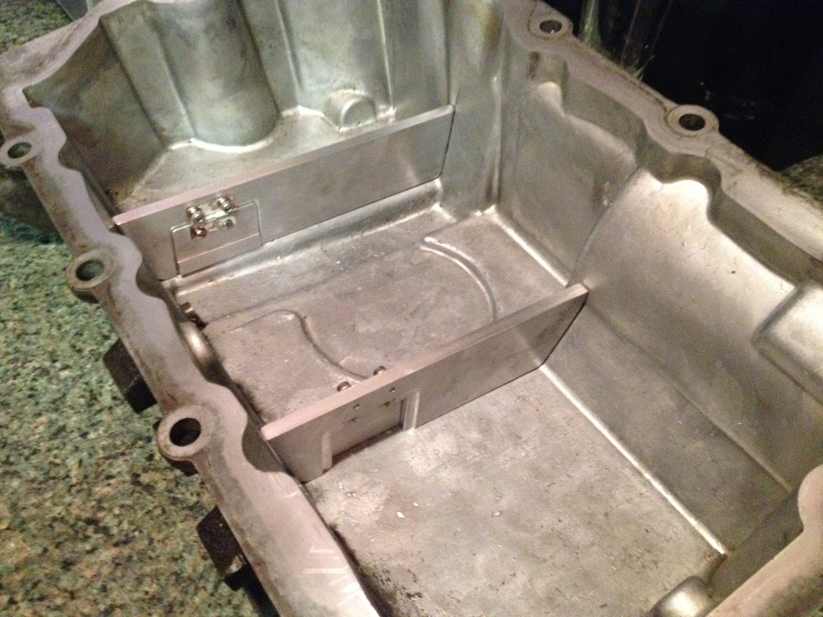

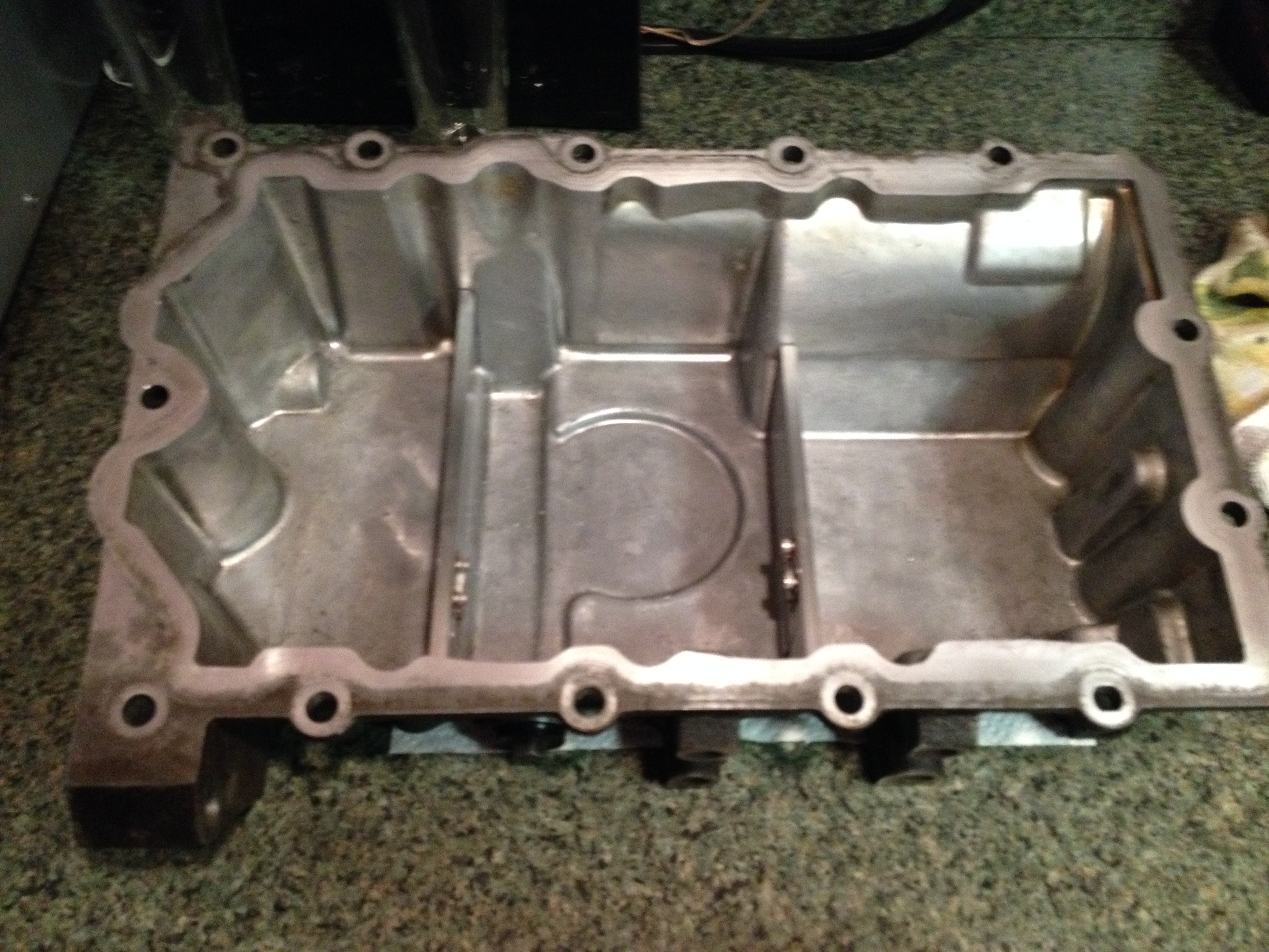

Also created an oil pan baffle. When I took the block apart the rod bearings showed oil starvation. Bill at Carlquist in CT told me this could be due to hard corning- all the oil flows to one side and the pump stops picking it up. Simple- two pieces with trap doors on each of them. You can find an oil pan with pieces welded in (without trap doors) and pay $399 +$200 core charge. Or buy a different kind of oil pan baffle for $175 from RMW. Instead, I made my own. Getting welded in tomorrow.
