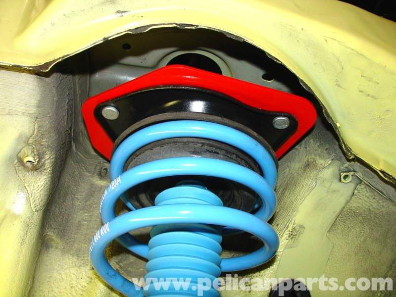

Be aware when you install the under tower plates you will raise the car slightly and reduce the neg camber in the front which you want more of. We just use the top plates with new strut mounts.

Should I swap the under plates for the top plates? Is that enough of a fix for the mushroomed towers after a sufficient reshaping with the typical 2x4 & hammer method?
The top plates are a great design that doesn't change the ride height, easy to install, and look appealing.
They are what we install on all of our customer cars, we don't stock the under tower systems as they are a more involved install, as well as the previously noted other tag alongs.

Some advice from our Strut Tower Reinforcement Plate Install DIY. Our R53 runs the Madness plates that go under the strut towers. Madness has some good information as well here. From our DIY:
The solution is to reinforce the area around the strut tower to better distribute the loads placed upon the sheet metal. Various companies offer solutions to this problem by offering reinforcement plates mounted on the top of the strut mount. The problem with this approach is that in order to fit across the top of the mount, a notch must be either cut or formed into the plate to clear the stiffening rib formed into the top of the strut tower. To do this reduces the effectiveness of the plate.
Mini Madness has come up with a different approach to this problem by mounting the reinforcement plate UNDER the strut tower, on top of the strut mount. The benefits of this approach include having a flat surface to transfer the compression load to. Also, the reinforcement plates are made out of thicker gauge steel than the strut tower sheet metal. This means that if your strut towers are already deformed, installation of the plate will pull the towers back into alignment when the mounting nuts are tightened.

I would as you don't need to beat the towers much as you can use the plates to pull it back in place. We keep the top plates in stock
