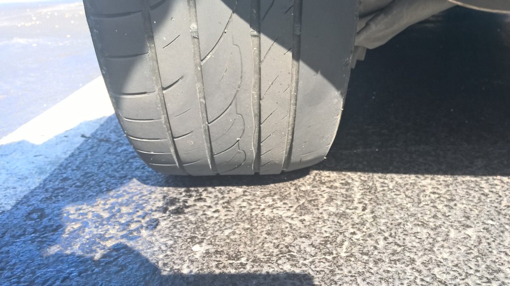

I can tell you one thing for sure....if you put lots of highway miles on your mini, the added camber from the fixed camber plates WILL wear the inside of your tires faster than the oem strut mounts. I'm on my 3rd set of tires since my IE camber plates........and I rotate my tires ever 5000 miles....and the best I can get from a set of tires is around 15,000-17,000 before the insides are worn completely down to no tread. The added camber does nothing for you on the highway except eat your tires.
If I had to do it again, I would just install a new set of OEM strut mounts. The IE fixed camber plates might be great for some added handling benefits on the track, but for a daily drive all they do is wear out your tires faster.

This is what my tires look like after 15,000 miles of mostly highway driving. Notice how the inside is wore a lot more than the rest of the tire. All of my suspension components are good (powerflex bushings, new end links and ball joints, power fles bushing). Alignment setting are close to oem with a little little toe-in in the front.

Looks like I will be going with stock now haha
