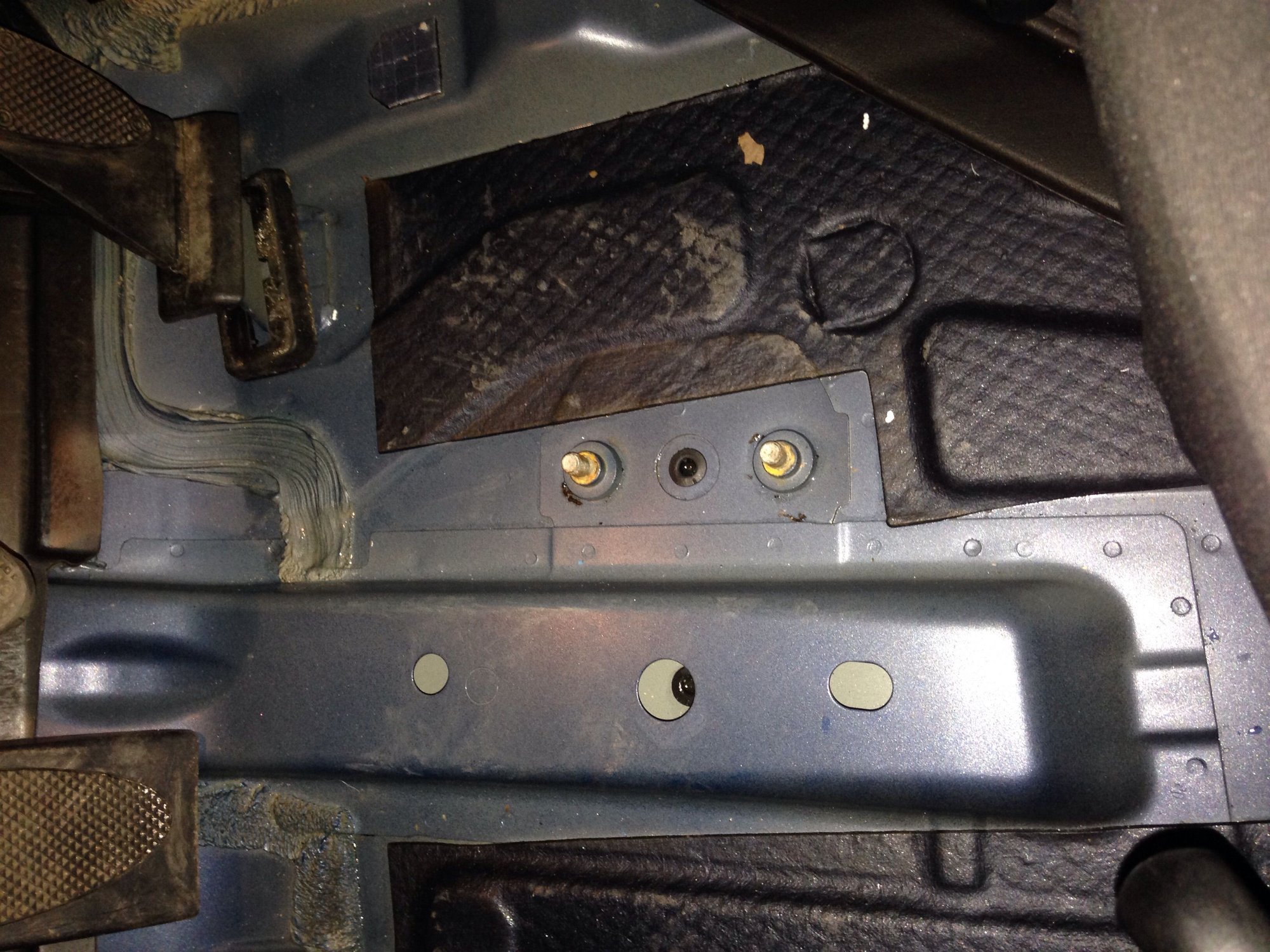

Driver side floorboard water seems to be coming out of these seams, not sure what is below that. Anything dealing with a/c is out of the question, it only happens in the rain. If anyone can tell me what is under these black-blue seams that would be helpful. Going to spray rust stop and seal cracks with some type of sealant.

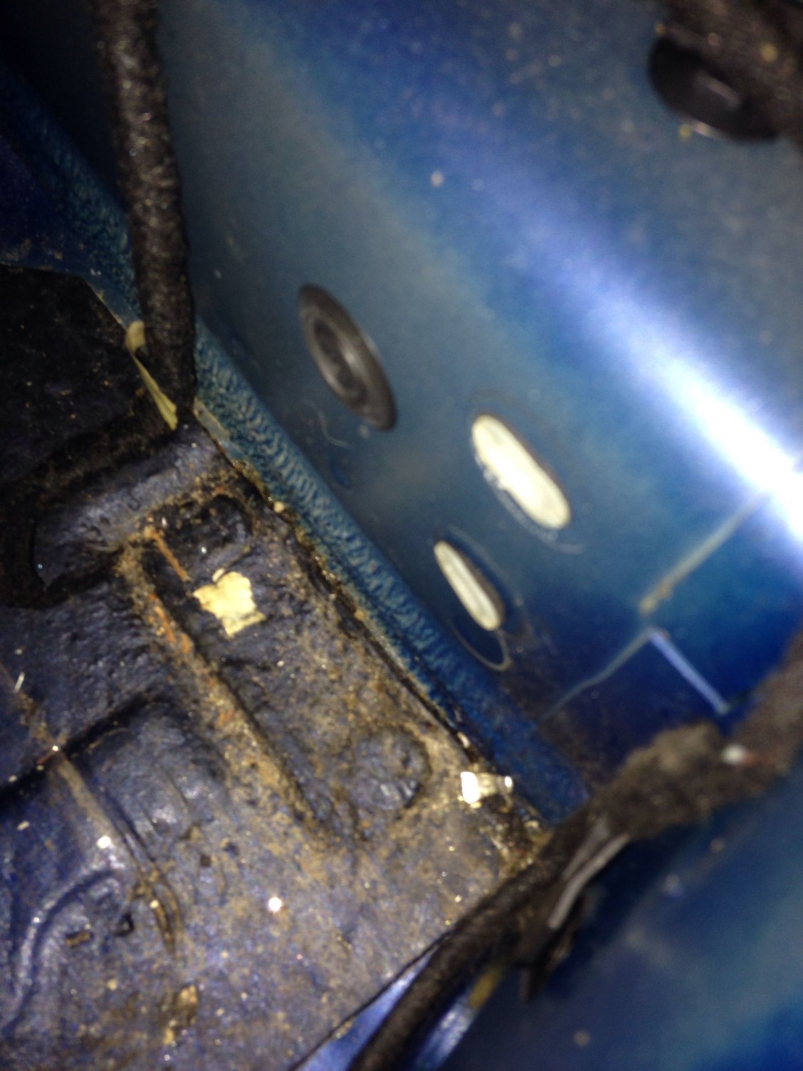

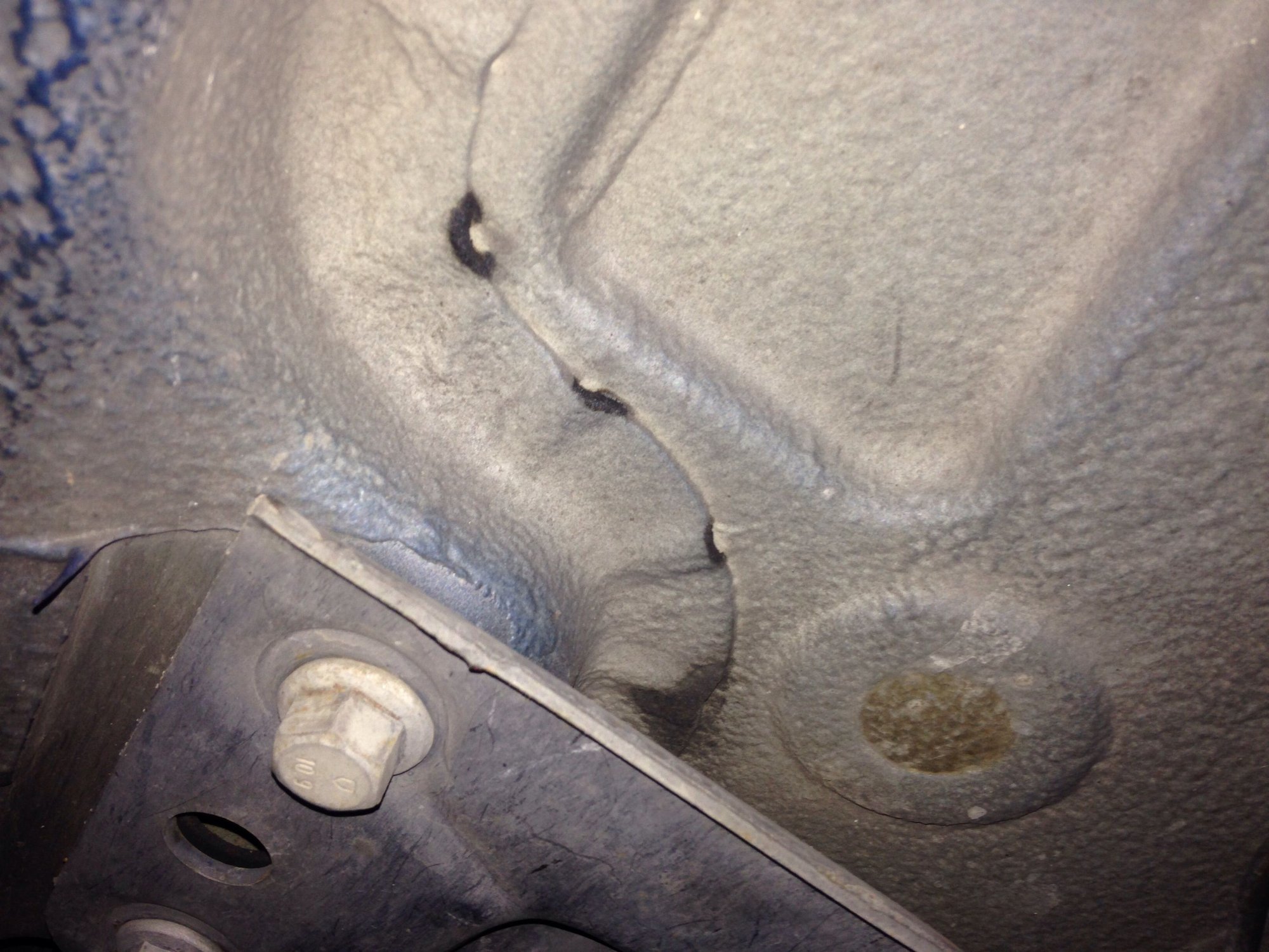

From: Houma, louisiana
Originally Posted by Khai
Sounds like what I had in mind. Will post when I find anything out.
Problem area in trunk. Seems to be these seals. Can't see bottom because of r50 exhaust though.
Problem area on driver side, same type seals. Water leaking down through these wrinkles, so I can only assume it can get up it.
Everything above the floor in the trunk is dry.
It is odd that these are all failing. But I will find every spot on the car that looks like this, seal it up good, and lay down a plastic sheet and make sure it doesn't leak again before putting my carpet back in.

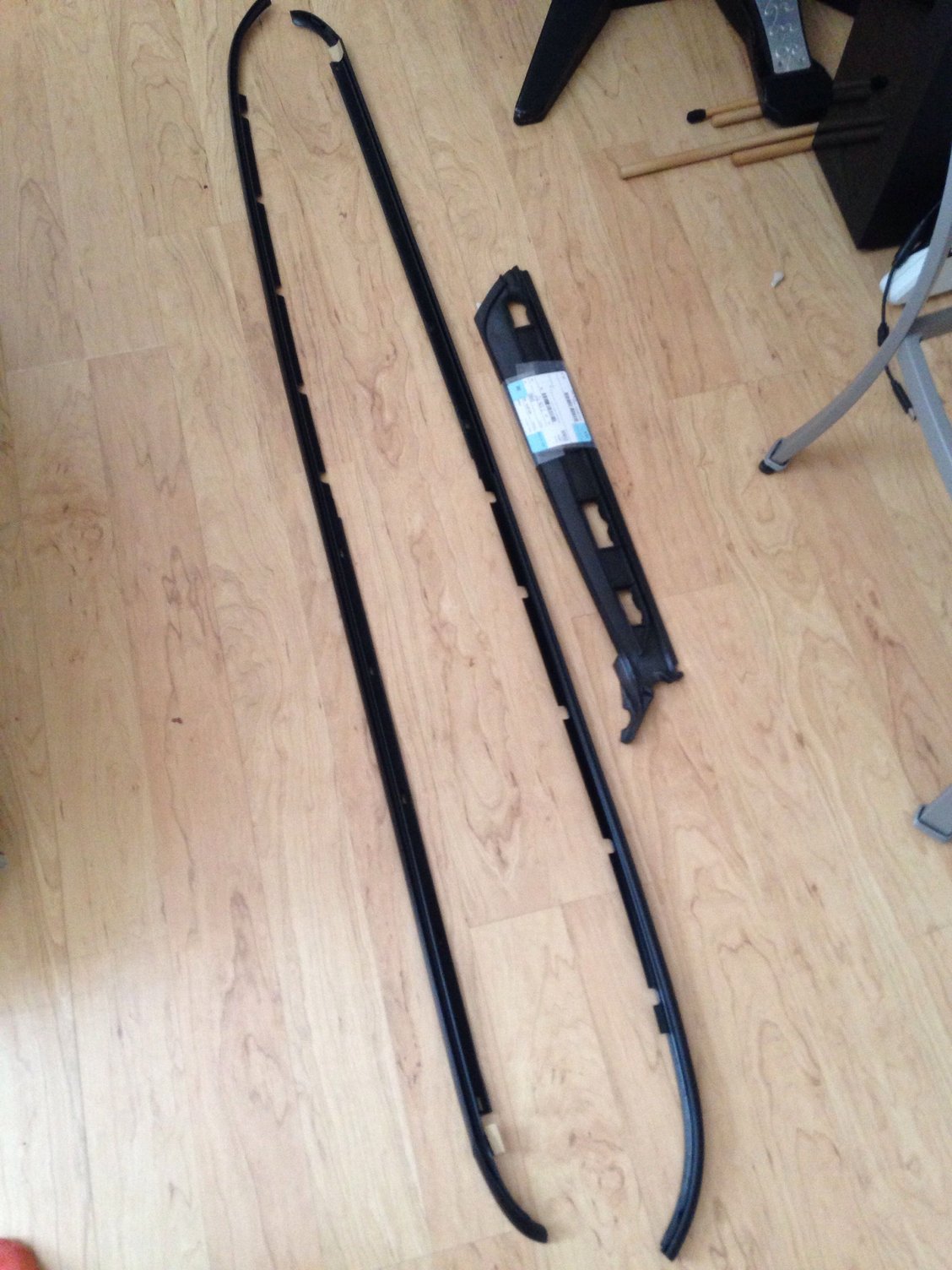

So I think I may have finally fixed my water issue, the trunk was fixed a while back by seam sealing the floor. The doors were a different story. In short form, I had to replace the two side roof moldings and the foam spacer between the a pillar and its plastic cover. I may make a video showing all of what happened to help other people, because I know I can't be the only one with this problem and I couldn't find the right information myself.

this is on the driver floorboard, the water seemed to come through that seam (this is what was happening in my trunk)
I used Urethane Seam Sealer to fill the gaps
I was paranoid and a bit frustrated so i seam sealed everything.
