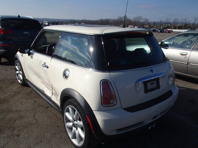

Anyway, no build thread is worth anything without pics. These are the internet pics that I have from Copart. The interior is very nice, the engine is unmolested in any way, it started right up after sitting for two months and purred like a kitten. It doesn't smell like it was a smokers car. There is not a spot of rust anywhere on the car, topside or underneath.
I got it home, got the door open. This should be the only challenging part of the job.

So a few updates with the car. A plan for the drivers side. We are going to replace the pillar and quarter panel. It will be cleaner, better, cheaper??? than attempting to repair it. I picked up a door today along with a new passenger side handle for 175. I am actually very happy with this as it includes the everything except the mirror which is fine on my door. I thought all I was getting was the shell and I was going to have to buy some parts to finish it as the window mechanism isn't currently working on the smashed door. So a nice bonus there for me.
The passenger rear quarter is easily repairable so no need for parts there except for the arch trim and the running lights behind the tires. I knew there was some suspension damage back there because the tire looked just a little off but I couldn't find what was bent. I could not find anything bent or broken so I was starting to think the alignment got knocked out of whack but my friend looked a little more closely than me and found the trailing arm mount was moved and slightly bent so for $100, I will order a new one of those.
That's the complete list of body and suspension damage so I'm pretty happy with that. No real unexpected damage which you always have figure you are going to find. My M Coupe had just a few thousand of unexpected extras so less than $200 on this car is a complete win in my book.
Other things to note upon further inspection. It must have had a recent brake job as there is a ton of pad life left. There is only one puddle of oil which is coming from the oil drain plug. I almost wish it was leaking from more spots as it makes it easier to spend the $$ for all new oil seals but I know if it's not leaking now, it will be shortly.
