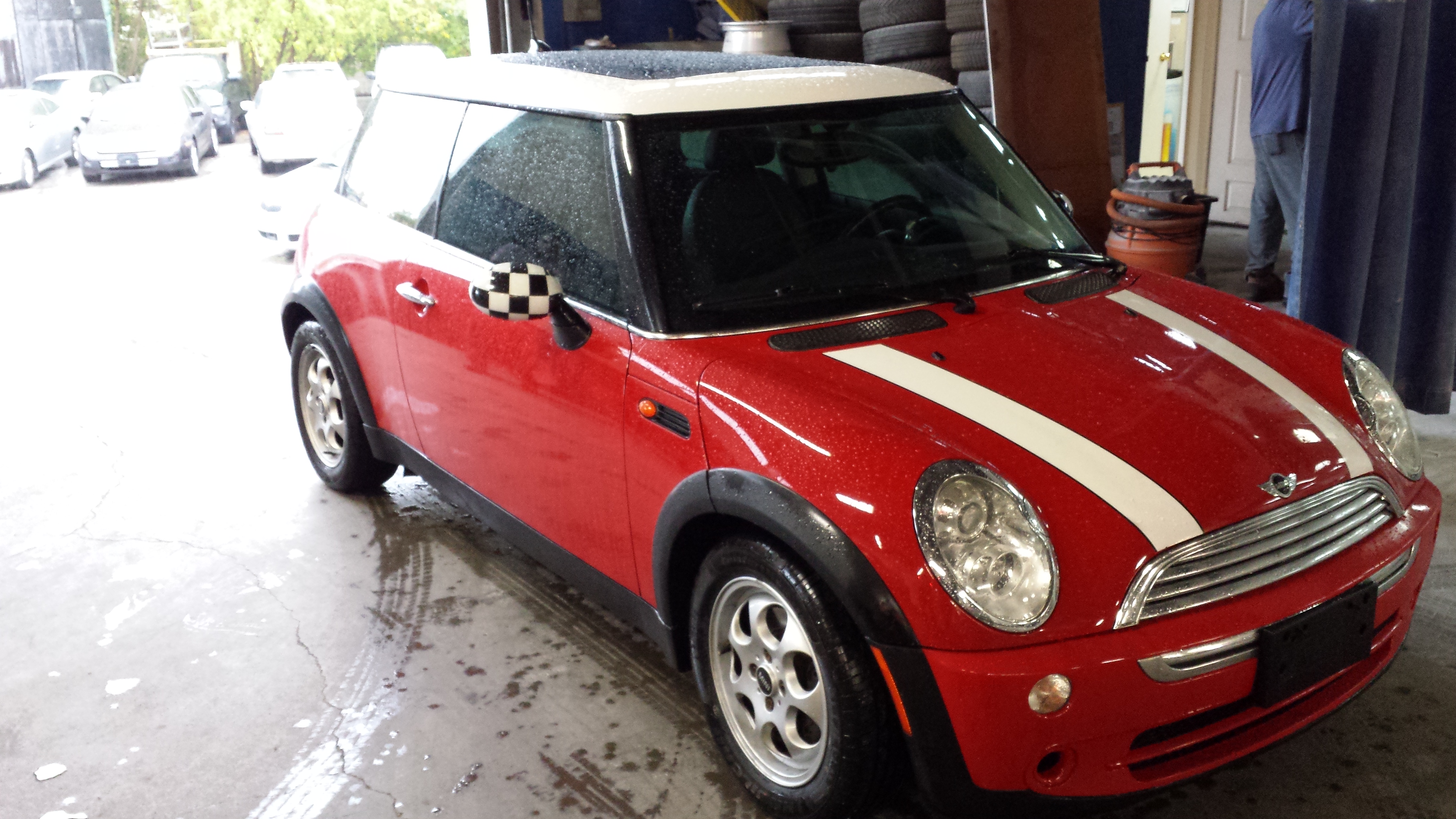

Like I mentioned in an earlier post, I bought the car for my daughter who is away at University and is also a new driver, this can only help to alert her the keys are left in or maybe that the lights are left on? 1.5 hr drive for me to go boost her,(ha,ha)2005 Coupe Chimes/Audibles/Alerts-20150929_155007-1-.jpg
2005 R50
