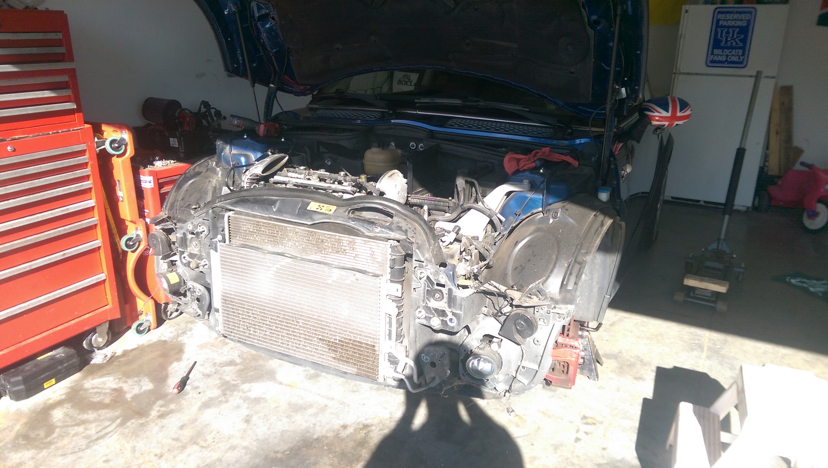

Well as some of you know , I worked my way into a 2003 mini Cooper s 6spd, India blue. The car was a no crank issue when I found it. And we'll found the problem to be tosiezed up motor. So now it is time to prepare the Cooper for a engine transplant.so I figured I'd open up a separate thread for everyone to follow. This is my first mini and my first time doing the operation on one. So bare with me.any insight or tips are greatly appreciated. It may be a slow build since I'm out of town all week and only get weekends. So here we go.
Here are the first few pics of the mini up until the front end service mode where it sits now.
Now into the garage we go!

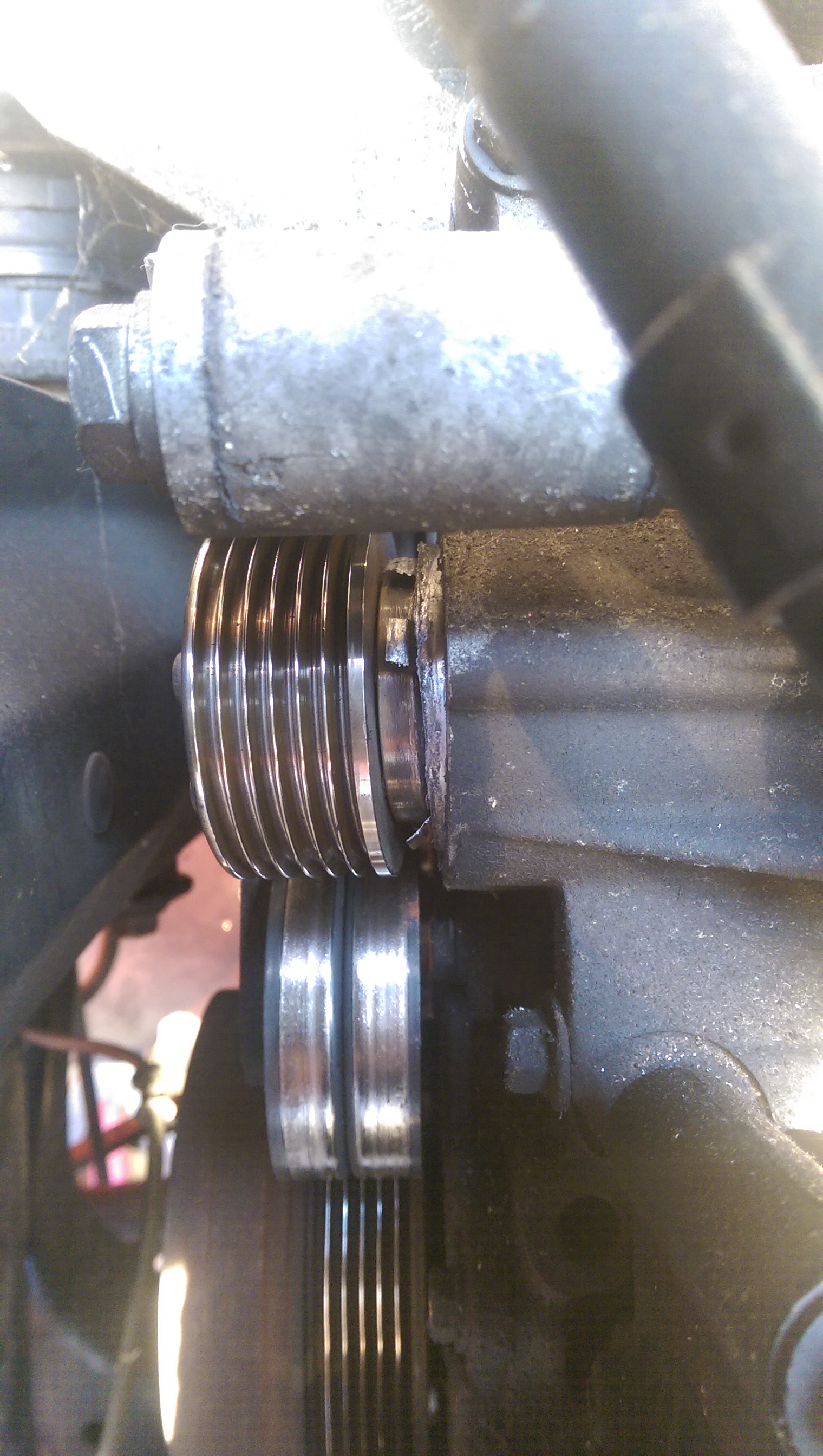

Well I'm continuing to tear the car down. And found Tue motor to not be locked up but the supercharger and I'm assuming when they push started it or what not it bent the drive shaft in The charger.so now The question is do I keep this motor and replace the charger or just replace it all.. Here is the pic of the charger

S/C pulley swap gone wrong? If it was me, I'd crank the engine with no belt and check the compression, if it's good, just replace the s/c. I mean, those engines aren't really known to fail, it's worth spending 15 minutes that might save you some money for other parts and maintenance.

maybe so...the owne before who i got it from had the pulley and all mods done. theres atleast 5k on mods that i know of. ill compression test mext weekend. trying to get supercharger off tonight. before i head back out of town.
the only thing is the owner who i got the car from had mini of louisville ky do an oil change, then 1k later had a oil pressure light come on, they found sludge and flushed the engine. that was 4k ago and no problem until this. the whole front of the engine is covered in oil. they found a valve cover leak and the sensor on front is leaking. so hope change those and supercharger and all be good.

Wow...interesting failure....
Maybe it siezed..guess the bearing failed and it jammed up...
You should be able to run it without the belt....just take of the intercooler...
You will have no WATERPUMP...so don't expect more than a couple minutes max...but you can see if it runs OK. Might be worth yanking the valve cover to look at the cam...knowing the car ran a bit with low oil psi makes me wonder.

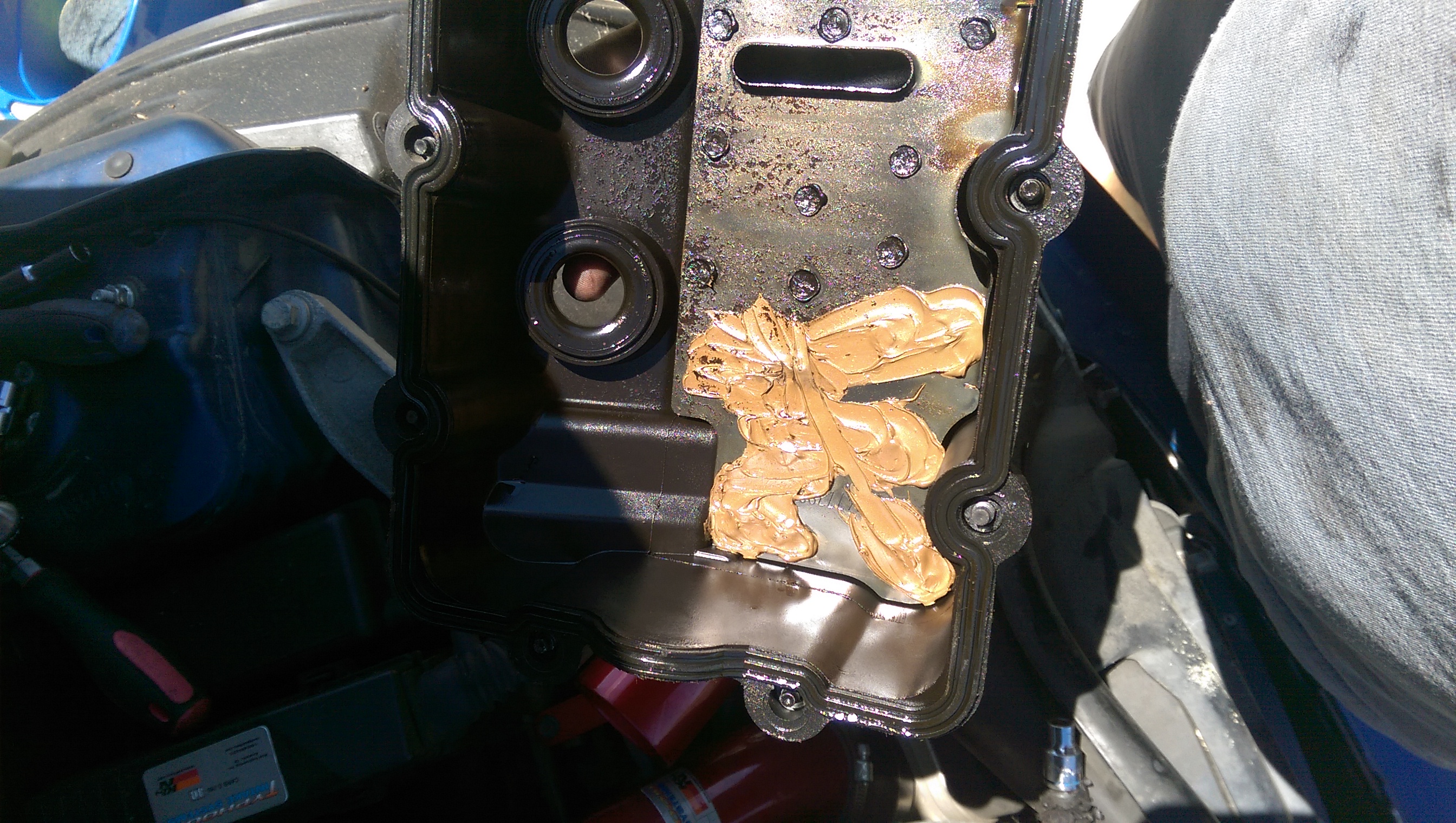

Also I did find this under the valve cover its hardened.any idea what or why

Old Aug 3, 2015 | 06:19 AM
Posts: 36,758
Likes: 2,548
That's just the manufacturing epoxy. I remember the older design valve covers have it. I think the original color was gray. 11128658461

Old Aug 3, 2015 | 06:23 AM
The_Kid's Avatar
The_Kid
Joined: Nov 2010
Posts: 144
From: just east of cincy
Good deal. Nothing to worry about then..
now just to determine if motor is good n 15%pulley is reusable

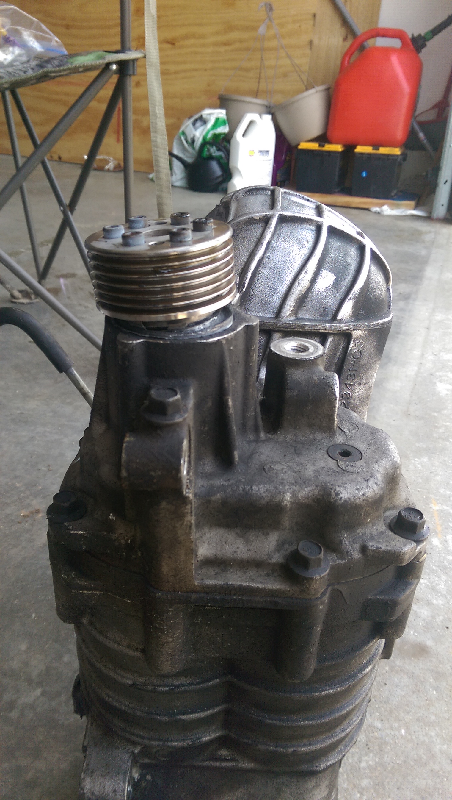

Suggest that, depending on whose make, removing the 15% pulley may well distort it. You can't use a standard size puller because is smaller in dia. If you buy that used s/c, hopefully, it will still have a std. pulley on it. Use it to diagnose the engine health before you go any further.

Yea I was thinking it was distorted since the drive shaft to the charger was bent.. you can somewhat see the bend in the pic of the pulley. Looks like I'll be ordering a 17%. Depending on what his price is on the used charger I may end up getting a low mile swap 1300 with charger. Then keep the other engine around for a build or sell to make some of the money back

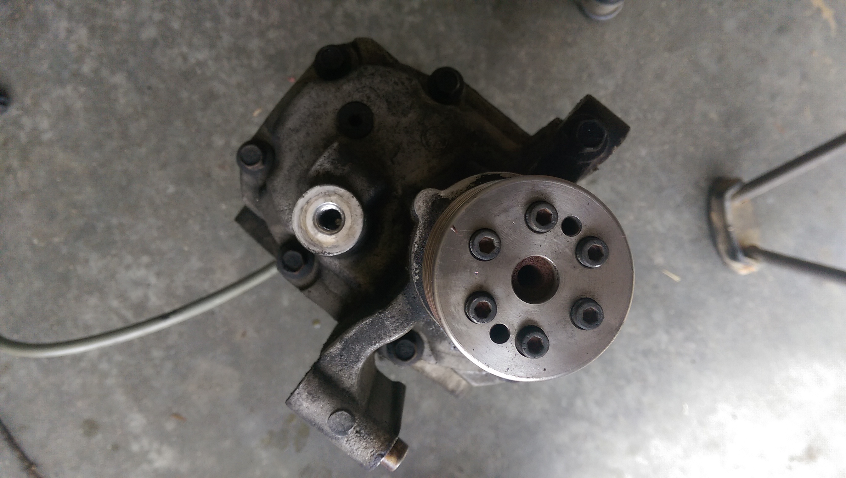

does anyone recognize the pulley. it doesnt have any markings on it. gonna attempt to pull it and lay it on a level surface to see if it is in usable shape

Not sure, but it looks like my helix.
Yes that is a Helix pulley. The pulleys don't go bad so you should be able to reuse it as long as you don't damage it getting it off.
Yea just wondering with the charger shaft being bent iifit affected the pulley or now .
I just picked up the new supercharger for the car. So have to pull tht pulley and the helix pulley. Any easy methods with both chargers off the car

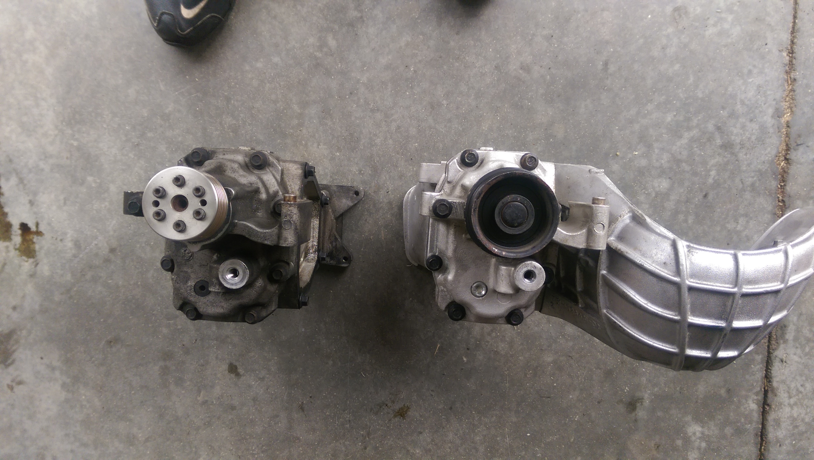

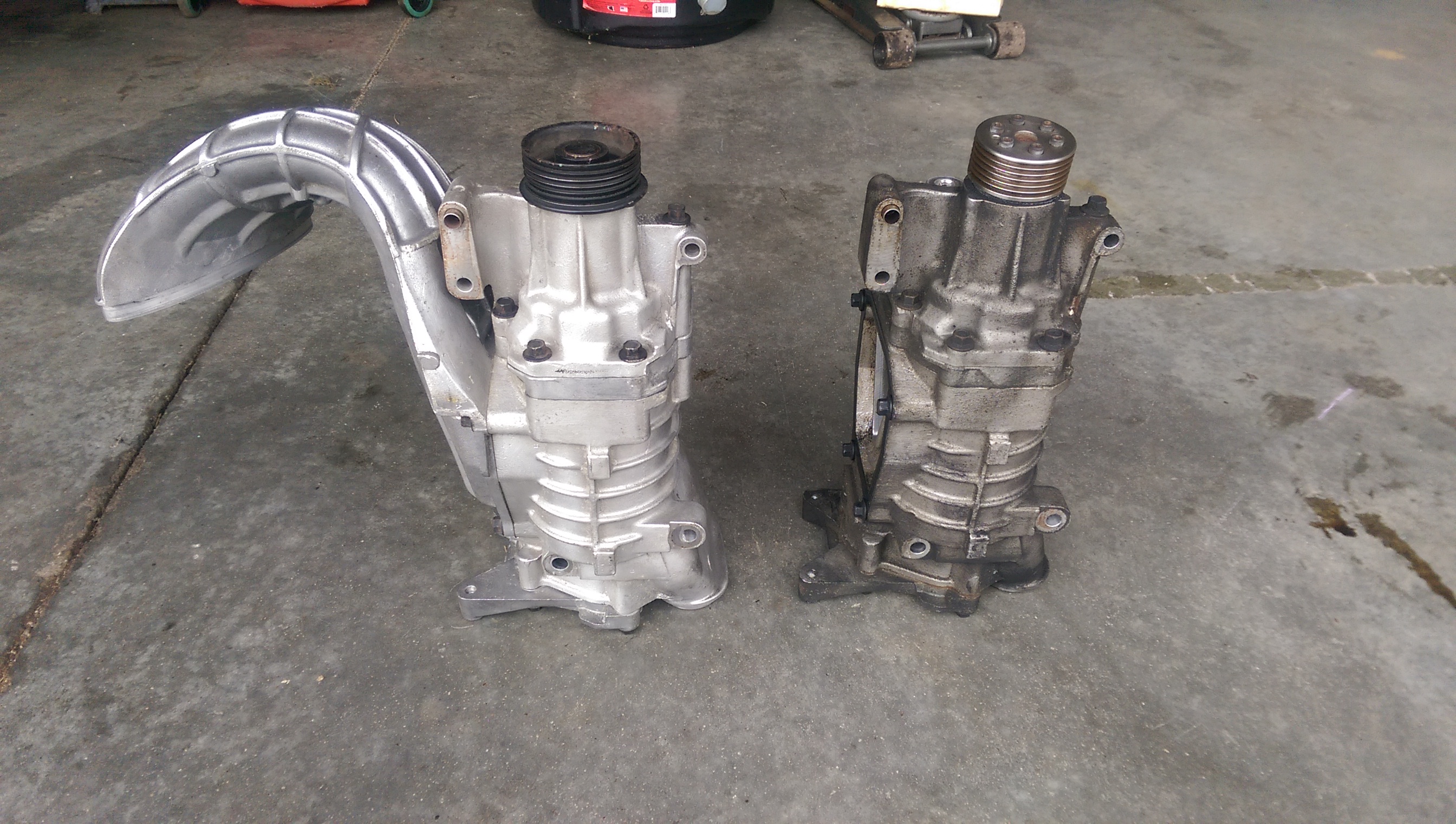

Well here is the new charger vs the old. Waiting on a valve cover gasket and crank sensor o ring along with fluid for the charger before 're install. I would also like to swap the pulley before installing the charger.

Aftermarket pulleys come off with an Allen wrench...
If some locktight (well advised) was used on the nuts, you might need some heat to soften them..
The aftermarket pulleys DO NOT NEED a pulley puller...they use a Allen wrench and licking collar arrangement.
Only the OEM (all) and the VERY EARLY (only A HUNDREND or so) reduced pullies pulies needed a puller....these pulies have zero bolt holes, and were heat set.

If the SC is off the car...you can carefully CUT the OEM pulley off...a couple cuts with a cutoff wheel...two or three cuts...go shallow...avoid nicking the shaft...
Using heat risks taking the out (hurting) snount bearings on the SC....or the plastic sheer coupler...
Alternate method usually used on the car us a SPECFIC PULLER that is a perfect copy of the negative of the factory pulley...usually in a half moon shape...a generic one DOES NOT WORK AND WILL MAKE A MESS...the arms do not grip a wide enough area...
The stock pulley is destroyed either way, but a generic puller will distort it, break off, and leave it still on, and messed up.don't even bother trying it.
