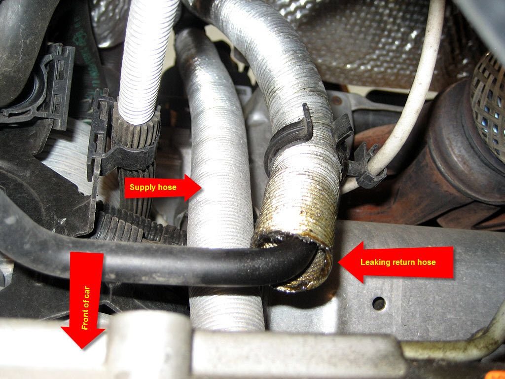

Here is the thread on the P/S pump if the lines are leaking, if its the P/S pump itself its in the thread also , they extended the warranty:
https://www.northamericanmotoring.co...hose-pics.html
Check the alt electrical line also. Sometimes they get corroded.
