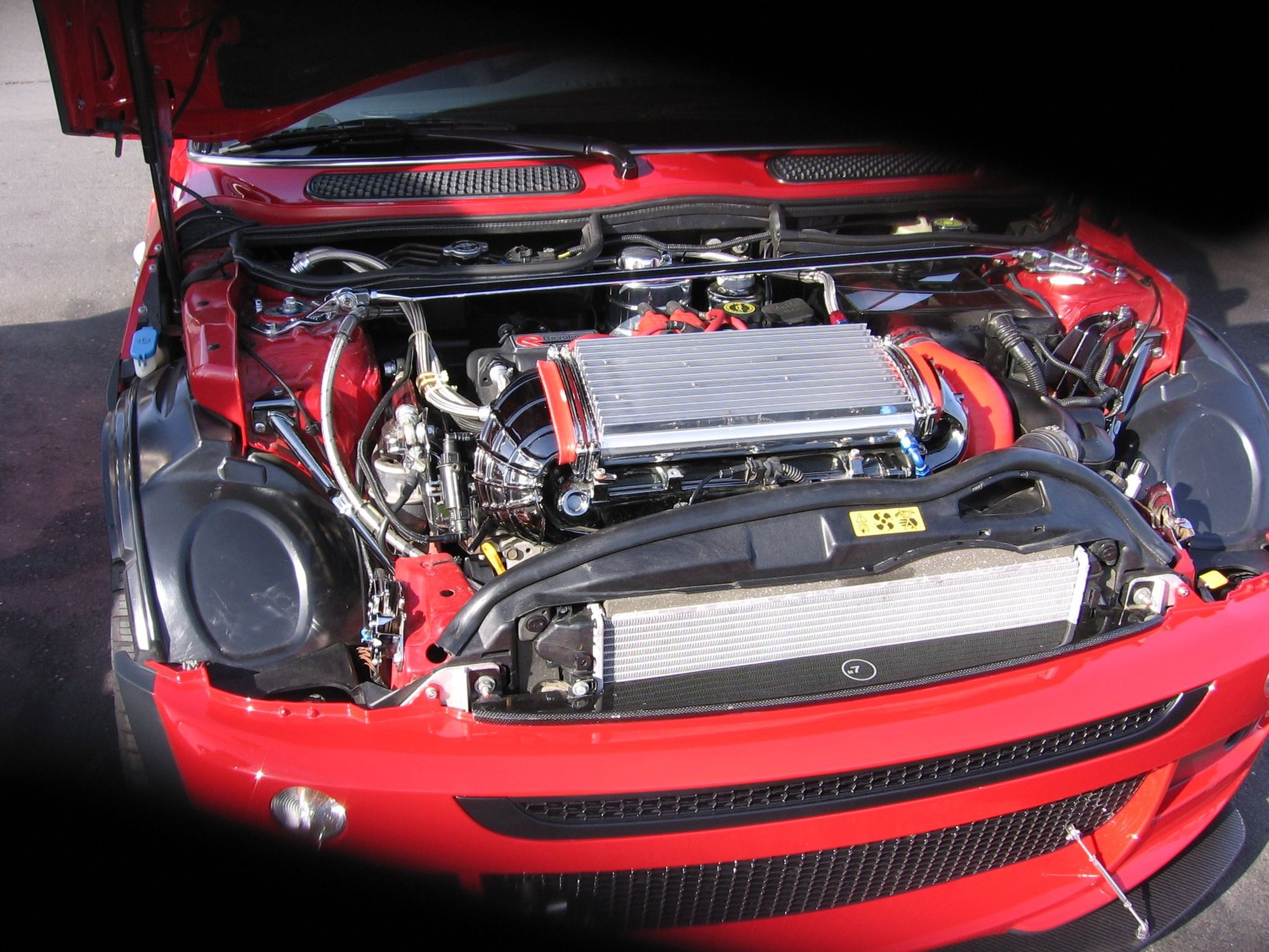

I have just about all the support braces you can have.
