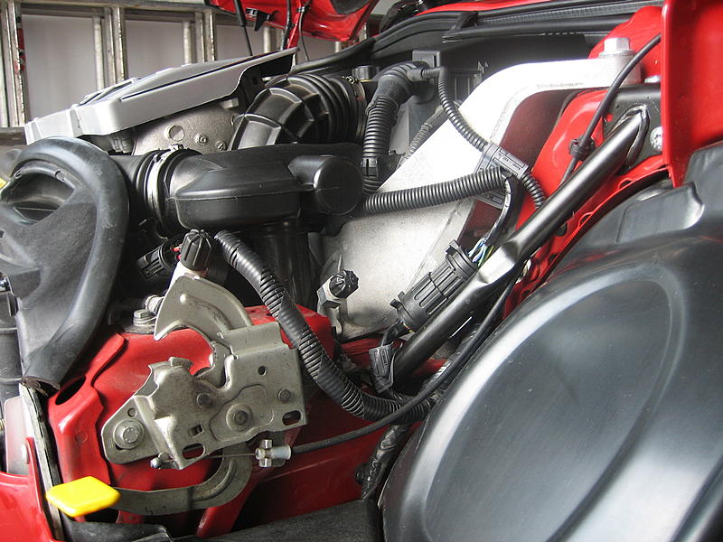

This thread helped me in putting them into my car so thought I would chime in... they are most definitely a noticeable gain in stiffness and thus better traction putting the power down... so you can come on the throttle sooner exiting corners and it also has better wheel control over rough pavement and lets the LSD deal with crowned roads much better. It does make the steering turn-in feel tighter but also "more FWD", with an increase in understeer, hence the good recommendation others here have made to upgrade to a larger rear sway to balance the handling.
For any Canucks thinking of doing this, parts cost at the dealer is $64 for the two braces and another $10 for the 8 bolts. As usual, more expensive than sourcing in the US, but then again you'd have to pay shipping if you purchased stateside. Price is still very reasonable given it is a very good improvement in wheel control under power and is a nice clean OEM mod underhood. Highly recommended!
And finally a pic of them in my JCW CE and a closeup of passenger side and driver side...
