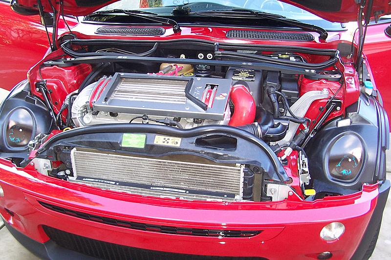

Here's a couple shots of the Cabrio Brace install on my '05 MCS...
Although the pictures don't really show it too well, the electrical wires were easily relocated adjacent to the braces. Both braces fit very nicely and were easily installed in the factory mounting holes. They came painted black, but the paint job was substandard... I chose to repaint them black, keeping with the theme of the other suspension components.
Attached Thumbnails Cabrio front braces on non-cabrio?-100_1998.jpg   Cabrio front braces on non-cabrio?-100_2004.jpg
