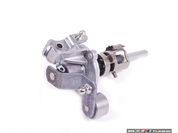

UPDATE
After more research - that shifting mechanism on the transmission is called the Switching Unit. And, yes, it comes out by removing the three Torx 40 bolts. Took just a little moving around to get it to clear the engine mount.
With it out I was able to immediately tell - the pivot arm with the cam on it is almost seized. Very difficult to move. It's not the main plunger shaft - it's the the arm with the cam.
I've poured WD40 on it and moved it back and forth a bunch of times with a wrench - only minor improvement. It's like the axle is too tight in the hub it rotates in. Of course it's a permanent rivet-type axle, so I can't take it out to do anything to it.
Open to suggestions.
Thanks.
PS - sure hope this thing goes back in as easily!

'Fraid it's none of those. It's at the other end - on the transmission. Under the air intake box, the transmission shifting mechanism that the shifter cables connect to on the transmission.
Here it is:
http://new.minimania.com/part/NMD863...it-Oem-R50-R52
On the left of that unit, in this picture, you can see the nub where one of the cables connects to. This lever has a cam on it that moves the entire assembly un and down when you move the stick shift left and right. That lever is tight. I spent a couple hours alternating WD40 and oil and working it back and forth with a wrench. It's improved, but I'm pretty sure it's still going to be tight if I put it back on as-is. And a new one is $280 - for a tight rivet-axle.

Spray underneath it on the plunger part and spray the pivot points. Also check the shifter cables again , if they pivot or the pivot end is rusted or coming apart.
2311754507 Switching Unit
http://www.ecstuning.com/Search/SiteSearch/23117545076/

^^^ Yes, that's exactly the part. I've got it out on the bench.
The cables are fine. They move finger-tip easy from the transmission end when they're disconnected from the Switching Unit - real easy to move the stick shift around from the transmission-end of the cables.
The plunger, I can tell, would move very easily.
The problem is the pivot point of that arm shown at the top of yor picture - the one with the cam on it to move the plunger up and down. It's so tight I can barely move it by hand - have to have a wrench on it to move it, even after a couple hours trying to lubricate and work it free. It's like the pivot's too big for its hole or something.

On my daughter's car, I started by replacing the shift cables. That did NOT resolve my issue. So, I ordered a new switching unit. It was 1000x easier to install than the shift cables and resolved my issue.
Here's what I replaced:
https://www.ecstuning.com/b-genuine-...t/23117545076/
