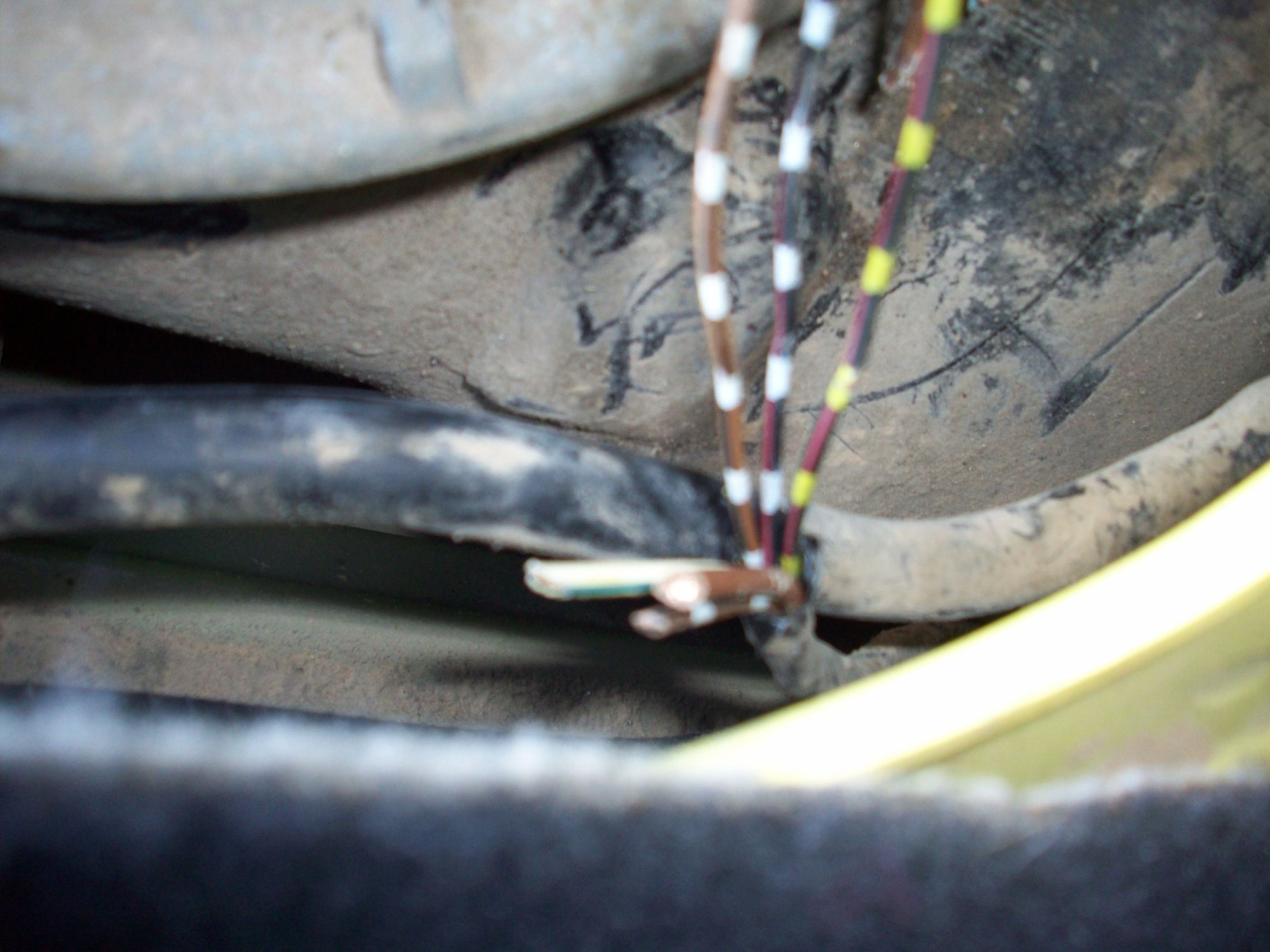

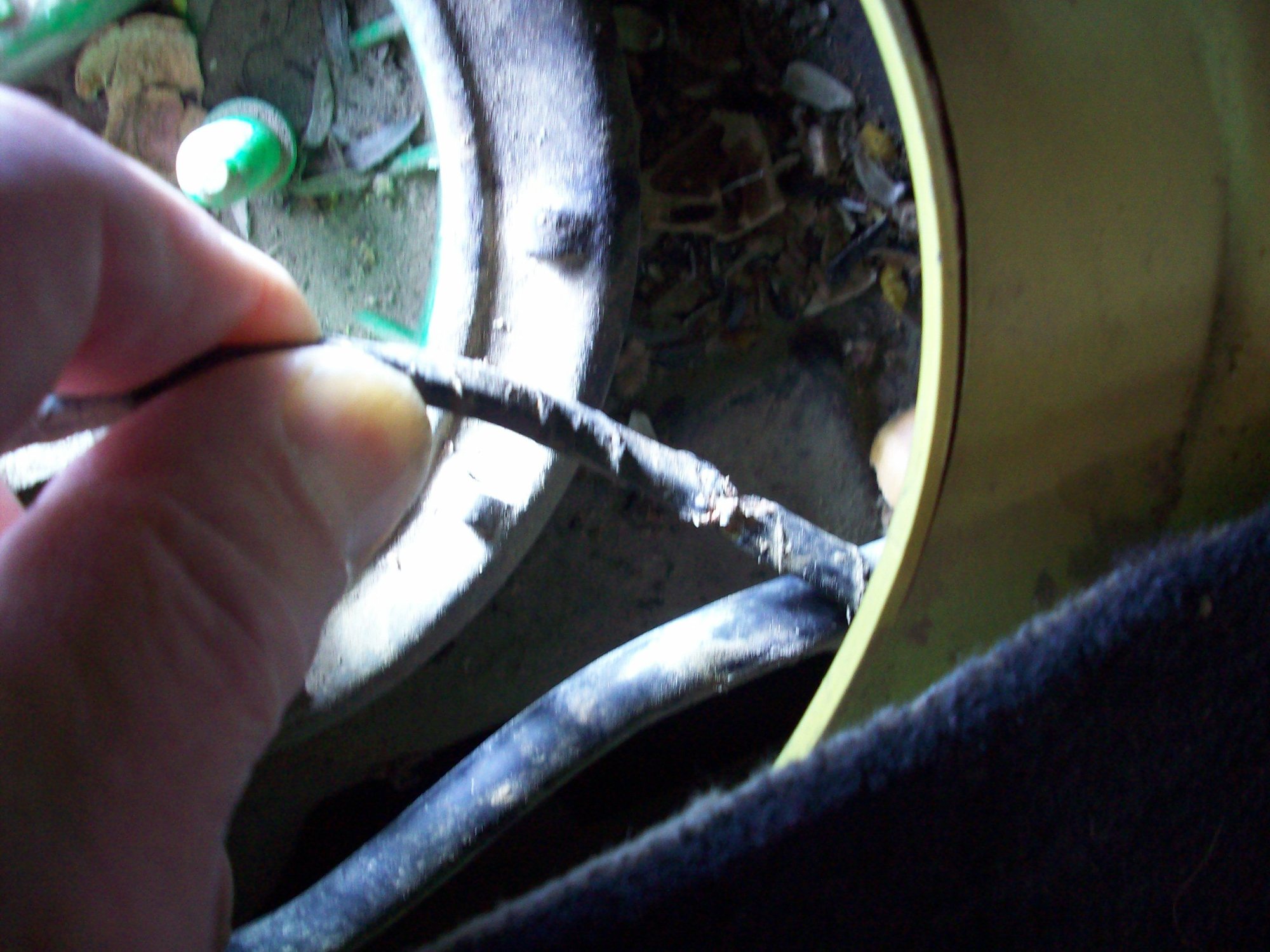

Hmmm. Maybe the rats got to the fuel pump and sender wiring? I*'ll have to see where they are. Any good videos on R53 fuel pump removal on you tube?
OK, I found several and especially one that shows how the connector unlocks at
The @(&^%$ rats chewed the wiring to my fuel pump and I hope that is the whole cause of my no start and non-reading gas gauge. I'll follow up when I get the wiring repaired.

Does anyone know off hand if the fuel pump wiring can be released from the bottom to get more room to do wire repair? It is really tight there on top of the fuel tank. I wish the rats had chewed it closet to the plug; I am having to practically stand on my head in the back to even reach the wires in the harness under the back seat sheet metal.

Probably have to drop the tank, or add some wire in between the breaks to make it easier .

I opted for the top side fix and used crimp connectors to splice the wires. I prefer to solder connections, but it was just too tight to solder the wires so crimps will have to do. After reconnecting the three severed wires everything worked again and there were no warning lights and no OBDII codes and my Schwaben/Foxwell scanner could communicate again in both OBDII and in Mini mode and found no codes or faults. I wrapped ti all with electrical tape and covered it with a red plastic wire loom and wrapped the ends of it with electrical tape and then wrapped the whole thing with Mouse Blocker tape and tucked moth ***** under the wires. I hope that discourages the &$@($ rats for awhile. They've been terrible this spring.
