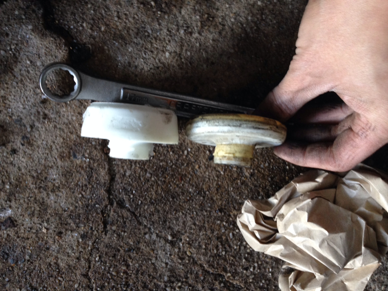

First, thank you for all the solutions and ideas ... I finally got some parts in and decided to take out the left rear suspension for inspection this AM.
First the top strut mount was flopping around quite a bit when I took it out...definitely not suppose to be like that.
I started by trying to tighten the Nut on top of the shock (after compressing the spring). Nope tight which meant only one other thing - bushings.
Take a look at the picture - the bushing is not supposed to be completely compressed like that - in fact the body of the new one is probably at least 10-15mm taller than the old one..the picture is not nearly as dramatic as real life. The strut mounts were replaced about 20k miles ago when I replaced the struts - it's a loemforder unit . Not so happy - the product is only $14 but 20K miles ???!!!
Anyhow - that's how I traced down my issue - now I hear rattles from the right side - I'm sure the right side bushing will be just as messed up.
