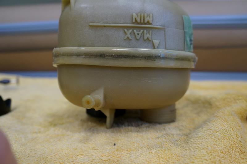

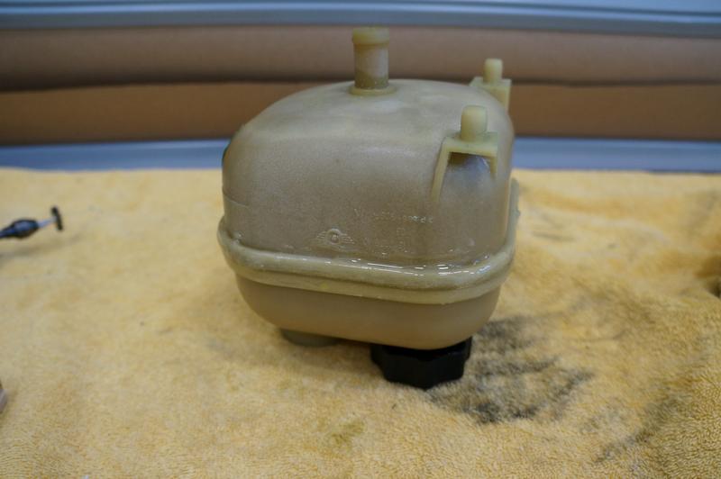

Hey everyone, long time lerker but a first time poster.
So I've bought an 03 MCS this past December with 87k on the clock. Sure there were a few blemishes but that's all expected out of a used car. One nagging and royally annoying issue I've been facing is the stupid CET splitting at the seams and pissing coolant all over the engine bay. CET #1 went within a few weeks of owning the car. CET #2 within 2k or so miles after that. I was stupid and should have gotten the aluminum can at that point but cheaped out and went for plastic CET #3... And surely enough, after my commute home from work last night I started to smell the now very familiar odor of coolant evaporating off the hot bits and noticed the coolant spilling from the seam right around the MIN/MAX mark.
Now, before I go ahead and order the aluminum can, I decided to make my last stand and try out a much cheaper "fix".
The idea is simple, take the CET out, dry it off and clean it from whatever remaining coolant might be in the seams and epoxy the crap out of it.
On the surface, this seems like a good idea but 2 part epoxies generally don't like, and I'm quoting, "Polyethylene, polypropylene, Nylon™, Teflon™ or flexible materials". I don't know the exact composition of the CET but I wouldn't be at all surprised if it falls under the first two as they are the most commercially applied polymers including the automotive industry. If this works, good; if not, I'll be no more than a few bucks short and on my way to getting an aluminum can.
To have the best chance of success, I scuffed the extruded surface of the seams all around and used an engraving bit with a dremel to get into the tighter space before applying a liberal layer of epoxy. Here are some pictures of the finished product and I'll check in once in a while to post updates whether this fix is something to go for or not:
Attached Thumbnails R53 Coolant Expansion Tank Fix-dsc00961.jpg   R53 Coolant Expansion Tank Fix-dsc00965.jpg   R53 Coolant Expansion Tank Fix-dsc00969.jpg

For those interested in using general 2 part epoxies to fix the seam; don't do it as a permanent solution. Checked mine over the weekend and there was a pinhole leak around the MIN/MAX line and this morning that grew to a 5mm or so split. Those epoxies do not like the material our tanks are made of even with the scuffed surfaces.
Having said that, this does work for a quick fix or to at least minimize leaking until a new tank comes in. Anybody have suggestions for an aluminum tank? I've seen people above list a few but wondering what the general take is for a relatively inexpensive upgrade?
