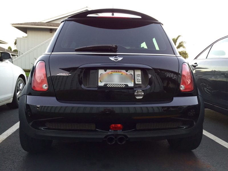

I finally got around to tackling this.

Old Feb 17, 2015 | 05:28 AM
Saltysalt's Avatar
Saltysalt
Posts: 2,257
Likes: 15
From: Dover, NH
cool beans! split them open and painted?

Old Feb 17, 2015 | 10:30 AM
808keith's Avatar
808keith
Joined: Dec 2014
Posts: 312
From: HaWaI'I
yup split them apart but the chrome just rubbed off with rubbing alcohol

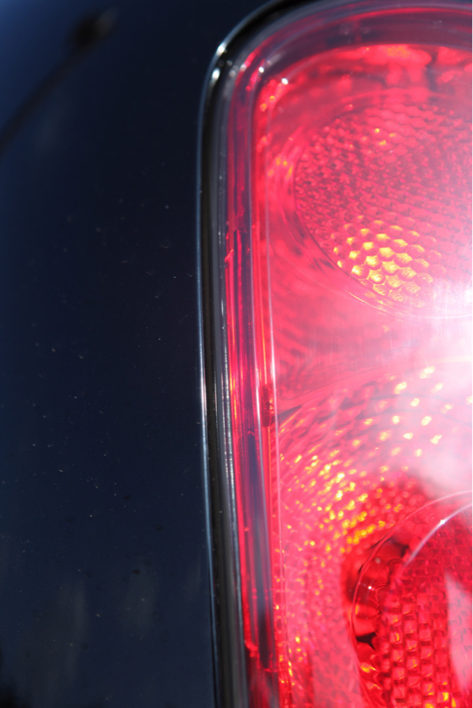

Old Feb 17, 2015 | 12:23 PM
dw1's Avatar
dw1
Joined: Dec 2011
Posts: 110
@808Keith: Can you post a little more on the process, I assume you removed the taillights then split them? Are they pretty easy to split?
BTW: great looking Mini and light treatment. Nice work.
Old Feb 17, 2015 | 01:28 PM
808keith's Avatar
808keith
Joined: Dec 2014
Posts: 312
From: HaWaI'I
You'll see where the clear lens meets the black plastic body the sealer/adhesive they used. That's where you'll be cutting through. I used a dremel with cut-off wheels but maybe should've tried one of those little saw blade attachments as the cutoff wheels kinda melt it as you go. Just carefully go all the way around and the lens will come right off.
Inside the red lens will pop out but you gotta be a little careful as it's held in with 4 tabs. Use like wide flathead scewdriver or maybe like a stiff putty knife to help pry it out. It sounds like it breaks but that's just it releasing from the clips. Once it's out, I used rubbing alcohol to wipe off the chrome paint.
When putting everything back together it's jus the reverse.. pop in the red lens and make sure everything is clean.
On mine one of the lens I used 5-min JB weld and the other I used black silicone adhesive. Just wanted to see which was better.. So far both seem to work ok no difference except working times.. the JB is quick setting unless you use the regular JB weld and wait till everything has cured over night.
Sorry I didn't take any pics.. with a 1 year old I had a limited window in which to get this project done..

Some more pics
Attached Thumbnails No chrome tail lights-image-4033985451.jpg   No chrome tail lights-image-876414908.jpg   No chrome tail lights-image-3220026049.jpg   No chrome tail lights-image-2173233522.jpg   No chrome tail lights-image-3984662192.jpg
