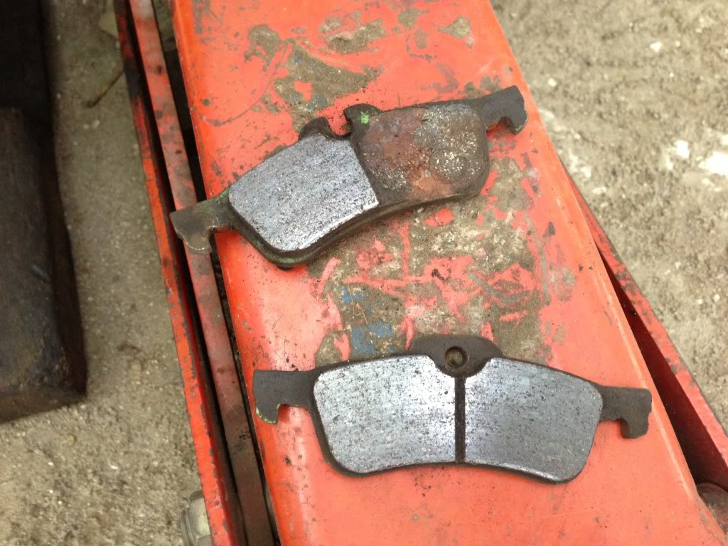

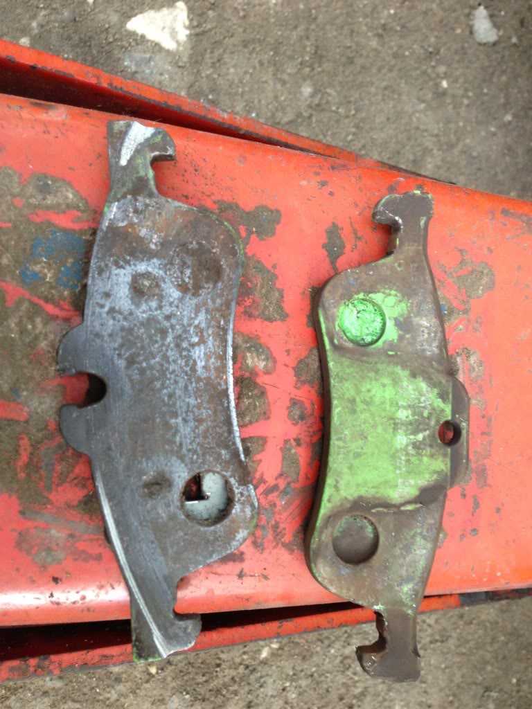

Brake pads.....stay away from EBC til they've addressed delamination. Mine did:
EBC actually has a new process of bonding the pads to the backing plates. The new EBC backing plates have the little tangs all over them and the pad material is heat bonded so they are double attached now.
