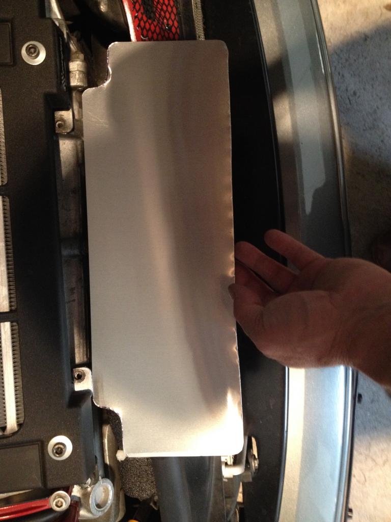

There is a micro switch on my pedal which is set to activate when pedal is fully pressed for WOT runs dumping CRYo2 onto IC. There is also a manual button SPST to cure heat soak.
I also insulated the upper radiator hose. That thing sends a ton of heat to the IC especially when sitting. I covered the hose with 3 inch pipe insulation from Home Depot. Then quick tied it around the hose, and fabricated a heat shield to keep any additional heat down. Now when parked for 30 mins in the store, IC temps are way lower and more manageable....
One of the cheapest and best heat management control devices I have come up with so far...and I had all the parts in my garage....hahaha.
In these photos, the rubber seal around the front wall was removed just to show what was done. It is back in place.

Pulled this topic up while the spring months are here and looking into various cooling options. I like the simple insulation of the radiator hose. Looking at adding that, but also curious about the heat plate in the photos. Was that custom built as well? Help direct airflow?
Thank you
Old Mar 15, 2016 | 12:39 PM
Saltysalt's Avatar
Saltysalt
Posts: 2,257
Likes: 15
From: Dover, NH
That heat shield is custom built. and its not to direct air flow, but to keep the radiating heat from the radiator hose @ 200 deg F making its way to the IC
Old Mar 15, 2016 | 12:46 PM
massmini03's Avatar
massmini03
Joined: Jan 2012
Posts: 54
From: DC/MD/VA
Great, thank you for the quick reply. I'm guessing a simple galvanized sheet metal?
Old Mar 15, 2016 | 05:52 PM
X757XVeritas's Avatar
X757XVeritas
Joined: Jan 2016
Posts: 649
Likes: 12
Looks like aluminum to me
Old Mar 16, 2016 | 05:20 AM
massmini03's Avatar
massmini03
Joined: Jan 2012
Posts: 54
From: DC/MD/VA
Aluminum was my first guest. But unless coated, it will corrode. I'll look into some options. Thanks guys
