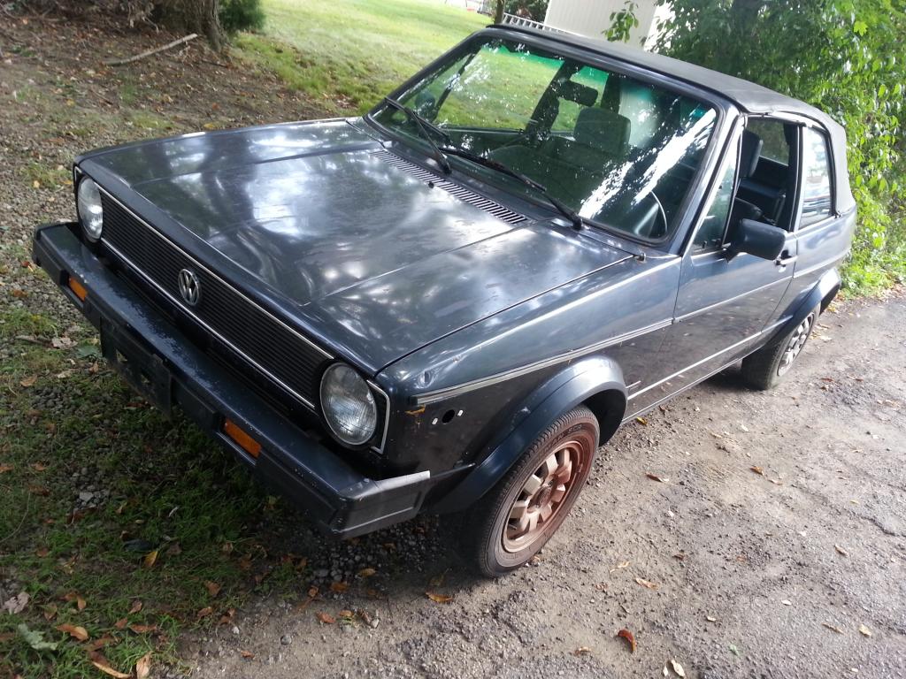

So I have a black '84 rabbit vert, and a helios blue '87 cabriolet (mostly complete parts car). I may restore both, but I'm starting with the '84 and will see how much of my budget is left for the '87. The helios blue is unfortunately in much worse shape, but its a more desirable color. For the '84 I'm planning a repaint in light yellow, an ABA swap (maybe with a 16v head), new top, new interior and all of the misc stuff that goes with it. The engine is ready to come out of the '84 now, and will probably be pulled this weekend. Overall though, its a long term project... the mini would hopefully be more short-term (fix trans and drive).
'84:
'87:
'84:
'87:
