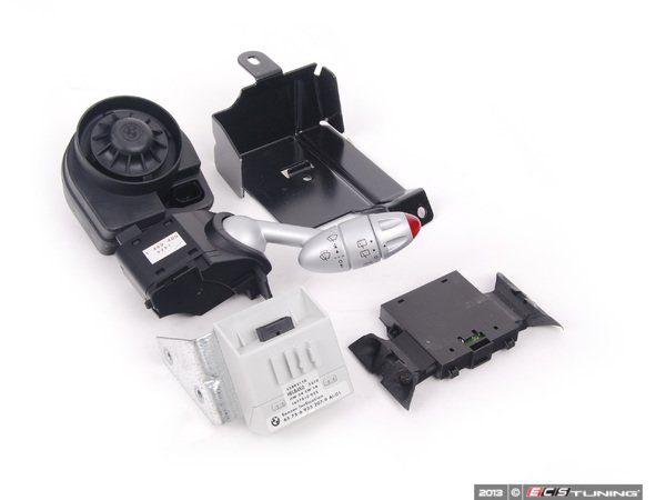

Posts: 36,758
Likes: 2,548
Yea, the alarm was not factory, it was just prewired encase you would get the kit. Example.
The cable plugs into the tilt siren. Round box in pics.
Old May 21, 2014 | 03:57 PM
jeffl's Avatar
jeffl
Joined: Mar 2014
Posts: 279
From: Spokane WA.
Well that solves the plug mystery. Now for the hose. Which I think is for the rear washer.
