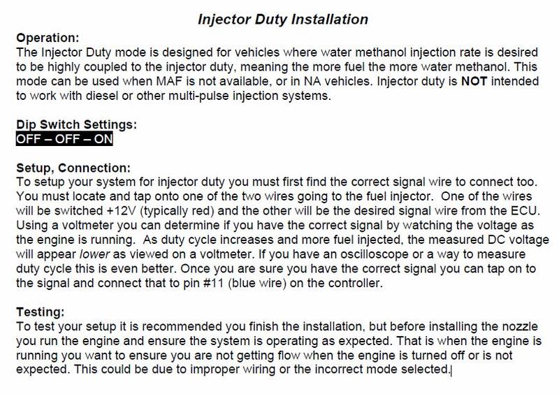

http://www.aemelectronics.com/v2-1-g...lti-input-1307
this seems like a decent system since you can run off of maf or duty cycle or boost
Old May 6, 2014 | 12:54 PM
c0op3r's Avatar
c0op3r
Joined: Apr 2013
Posts: 817
From: Orlando FL
That system will work fine:
