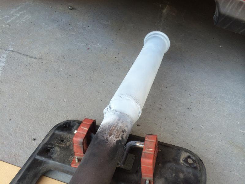

I installed the cat to my obx header and milltek exhaust. im using a 3 inch section after the header and got rid of the resonator using 3 inch pipe. check it out.
Its only been like 40 miles driven. i reset adaptations and so far no codes. keeping my fingers crossed for the next few days. stupid 2096 code

so far so good. no code drove around 500 miles gas mileage jumped to 26 27 too. from 24 when i had the 2096 code. get this cat really high flow cant be beaten.
