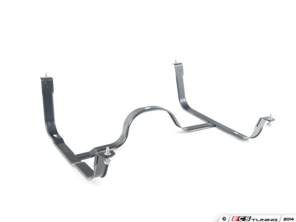

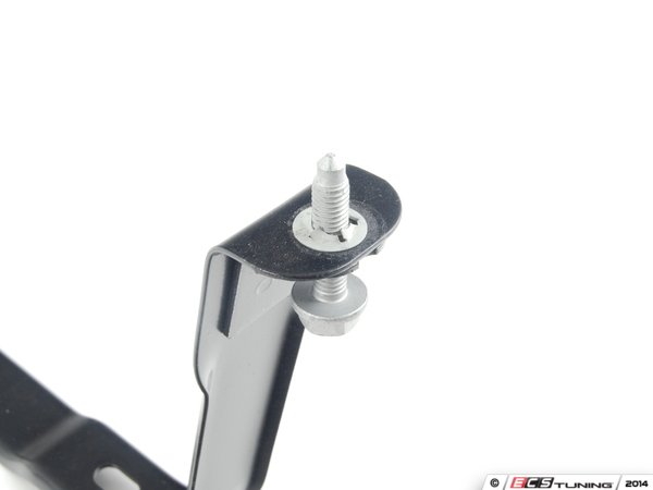

There is a set for the pre 7/2004 Gen 1 MINIs and the post 7/2004 . Must easier to change out on a lift and they hold it up with a transmission jack. New straps comes with the screws which are held with a little circlip so its easier to install.
Fuel Tank Tension Strap R50 / R53 -7/2004 Part #16111500998
http://www.ecstuning.com/Search/SiteSearch/16111500998/

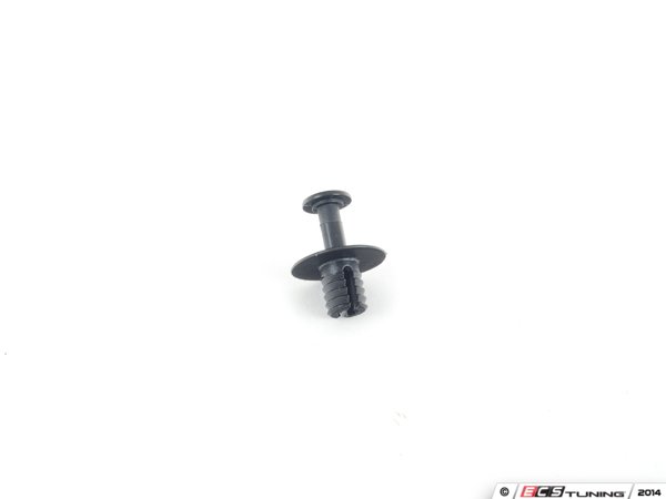

There are also little expansion rivets that you will need.
#3 in the diagram.
http://www.ecstuning.com/Search/SiteSearch/16136753087/ES2677304/
7/2004+ R50 R52 R53 They went to the two strap design.
Fuel Tank Tension Strap - Priced Each x 2 Part # 16136765008
http://www.ecstuning.com/Search/SiteSearch/16136765008/
#6 Expanding rivets
