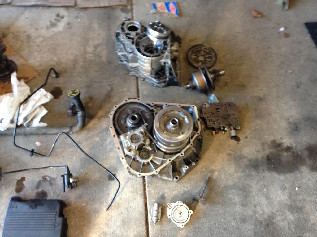

I took some pictures of the process. Wish I had a GoPro cam. Its not that hard really. I bought all the parts from http://www.europeantransmissions.com/ My cvt was missing alot of parts. My parts from them were the drive belt,rebuild kit(which had all the seals and clutch discs) filter, pan gasket. torque sensor, and other parts. Also bought there assembly video. Which helped a lot. I rebuilt the turbo 350 tranny in my 80 Z28 so I had a idea about what to with the seals and soaking the discs in clean tranny fluid. Theres a couple of parts you have to be careful with during tear down and re-assemble,other then that its pretty easy I think. Name:  D0A6654E-7B06-4538-A1F2-9B8ED2A7F57D.jpg
Size:  99.9 KB What I started with.

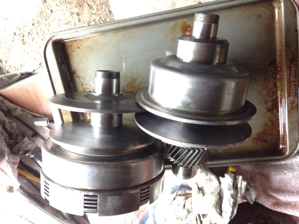

Size:  98.4 KB New clutch discs installed. Name:  3F9A8894-AC18-43BD-9B0F-CDACC44DB7B2.jpg
Size:  91.1 KB Secondary and primary all cleaned with new seals installed. Ready for the belt. I had to use sand paper on the pulley surface to get the old belt metal off.

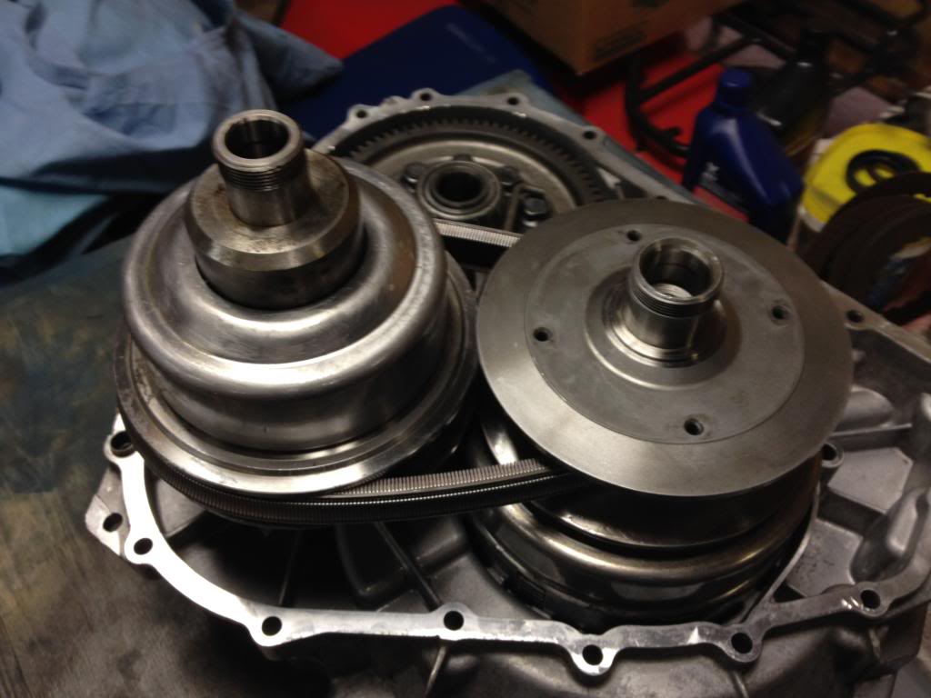

Size:  76.1 KBPulleys with belt installed.

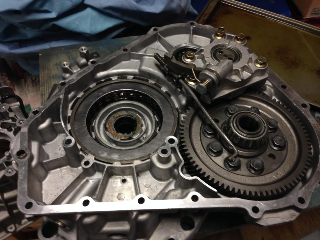

Size:  73.4 KB I wish I would have took more pictures. I did the adaption process myself also. That was different.

The cleaning took the most time. I 'm not sure on the hours, because I had other things going on. I'd say it could be done in a weekend if you stick with it. Another forum member did his also. With the video I bought to reassemble the cvt.
