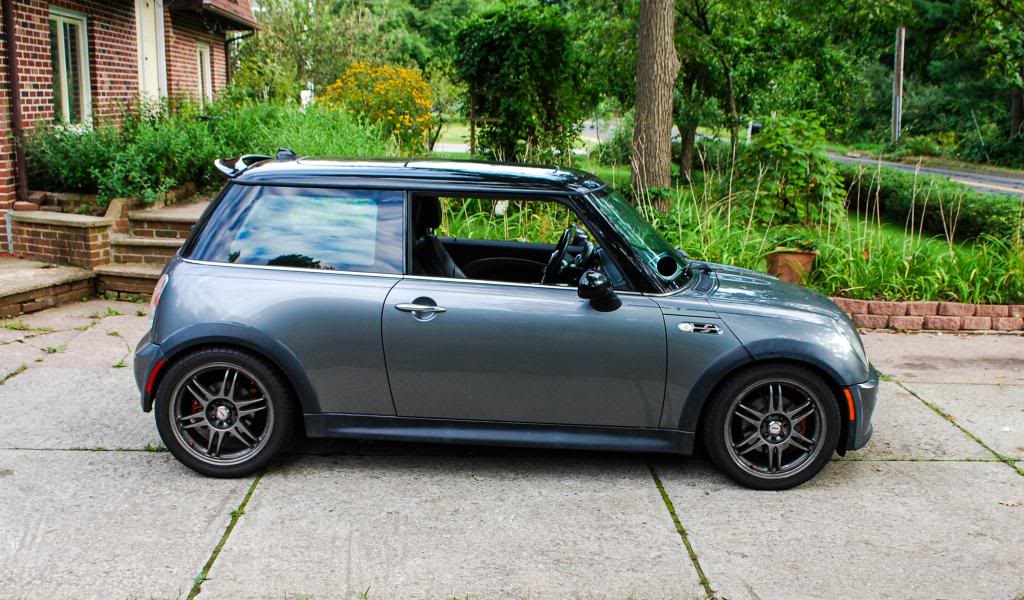

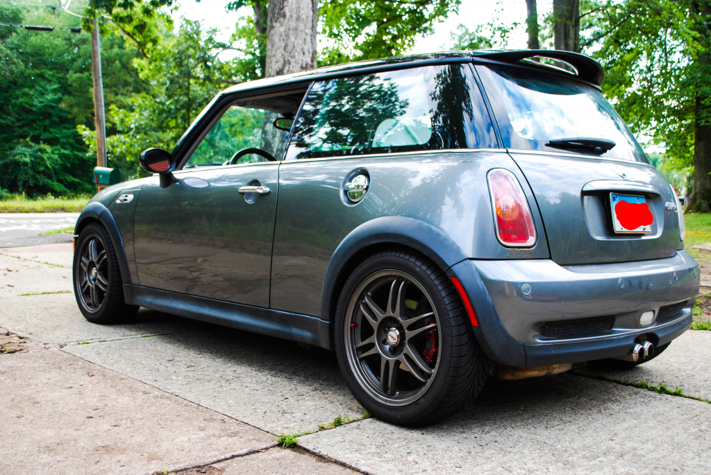

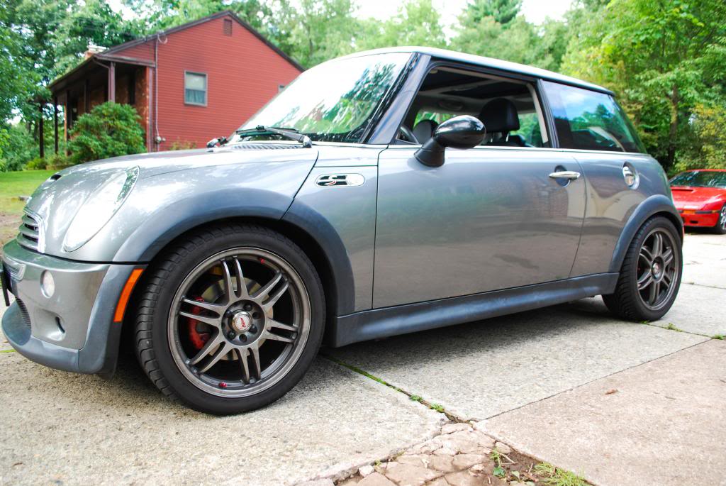

yea, 1 inch is good no real need to "fix" anything with that much. and should fill in the gap alright. like i said i run 215/45/17 and the 3/4 and 1/2 that the swifts gave me did a good job. it gave me just the right amount that i like.
