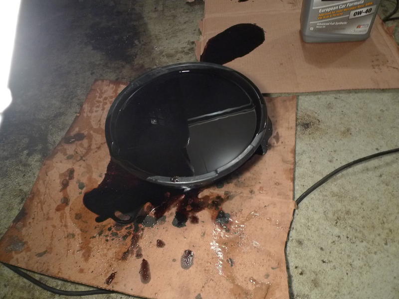

Posting all this a bit late, but finally have time to. I did all four of the front ball joints and upgraded to powerflex bushings from WayMotors
Also upgraded my long dead motor mount to vibra-technics right hand side motor mount.
Took me three freaking days though because my tools kept breaking. It gets really cold when the heat stops coming out!
Pile of parts wasn't as impressive as I thought it would be afterward.

Went to seafoam and change my oil today and found this.
Coolant in oil looks like to me.

id hold off on the head gasket issues for now. its cold out and there is going to be a heck of a lot more condensation in the motor now then during warmer days.
take a look and track your coolant level. its pretty normal to have the white gunky stuff during the cold months.

Half a can of Seafoam siphoned into the breather and other half into the oil. Smoked heck of a lot more than my jeep did with seafoam!
All looks good with the oil, which begs the question.
Okay, I'm curious now. What is that junk? Coolant level looks to be at the same height as always.
What is that stuff anyway? Why when its cold? Is it impurities, when the oil goes below freezing, separating out?
On another note, are those curly pieces of metal on the oil cap? or water droplets?
No, it looked like there was a few metal bits in the tub after I poured the old oil into the jug. Nothing I'm too worried about. Have a magnetic plug in there now from WayMotor's first oil change kit.
The actual water sitting on the cap may have been from the snow that was coming down. The tan/brown junk is what I'm concerned with.
its just water mixing in with oil. very normal stuff... ig you have a catch can it will have the same milky substance in it aswell. even if you bring the car up to full operating temp and drive it around a bit it will still be there, not as much as just turning the car on an off( not full warm up) but not a ton either.
it happens to every engine on the planet.

oil vapors, as mentioned above get a catch can to suck that out, best thing to do get a baffled catch can connect it to the valve cover and on the other port connect it to the intake so this way the vapors are sucked out of the valve cover and the baffled can keeps the oil from getting into the intake.
