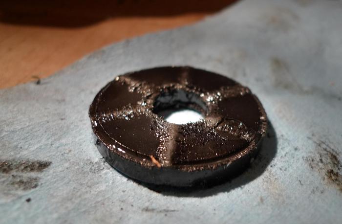

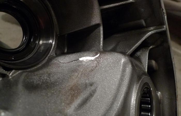

Here is the hole that the little piece of throw out bearing punched into the trans. It looks to be exactly the same size as the little piece next to the coin in my previous post. (no I don't have the little piece)

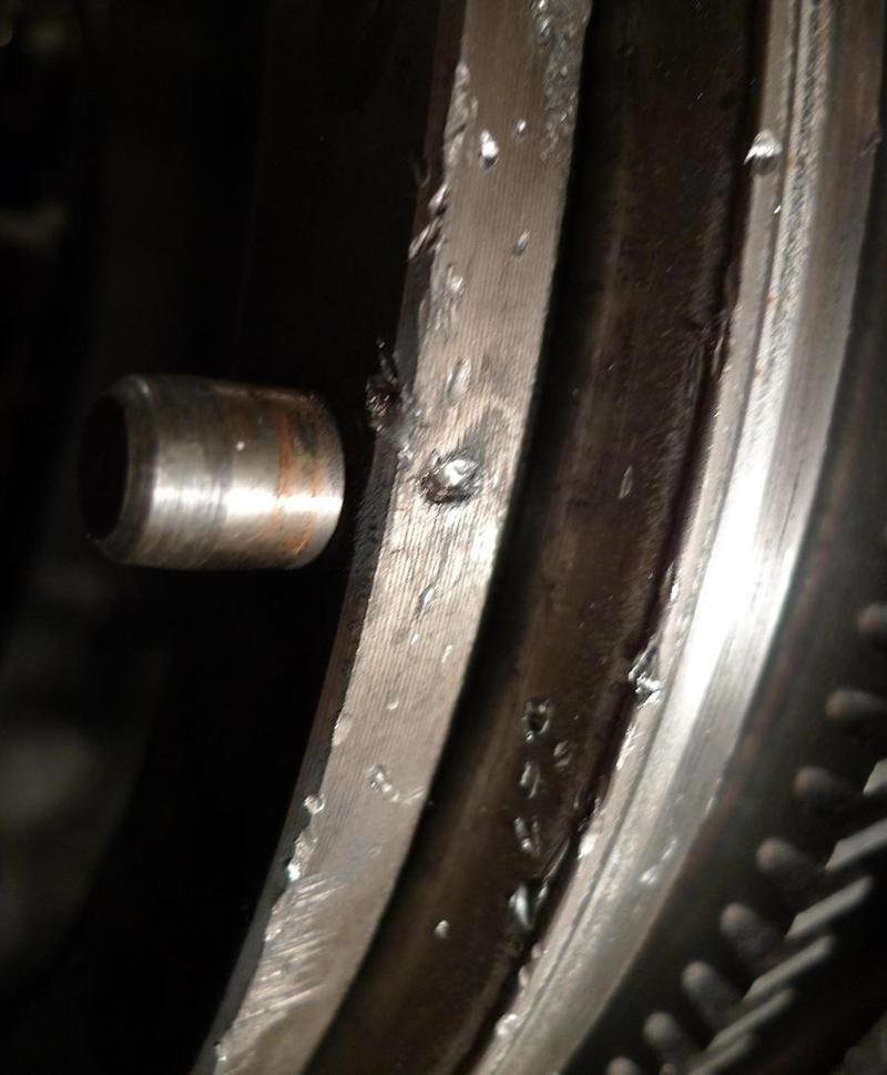

Fly wheel isn't looking too good either. Think I should replace it?
So, we're not sure on the new fly-wheel. I've got a new trans and we're going to try and find a new clutch/throw-out tomorrow.

if you want just weld that hole closed again. and re-use the trans. crack it open to take a look inside to make sure everything is in good shape, maybe clean it out. as for the fly wheel i wouldn't be to concerned about a few dings as long as the mating surface is fine.

We had a club member who's stock TO bearing did this on his '06. He was able to weld the hole up and reuse the transmission.

Yeah, we've got a guy willing to weld it back up already. We still need to open the trans and see what's going on inside still.

Any thoughts on a new flywheel?
I've been calling around to the local auto parts stores and can't find a Luk or Valeo. It's all Duralast, powertorque and United brand. I really wanted to get this fixed before Thanksgiving, but it's looking more and more like I'm going to have to wait for shipping on the right parts.
I'm also looking at single mass flywheels and clutches. I keep reading that they're actually louder than the stock dual mass and have chatter. I like the idea of it being harder to kill than the dual mass and that it's a bit cheaper, but am so hesitant at the idea that it'll have noise.
Looking for some input here:
i did not replace the flywheel on my car it was in great condition at 130K miles it was making noise at the time when i was cold but i dont have that noise anymore. new clutch pressure plate and TO bearing.
to be honest you probably dont need to change the flywheel. its just a few dings on the outside. bring it to a machine shop to have them make sure its balanced to make you feel better and or resurface it but i would reuse it.
i got my kit from germanautoparts.com you can also try minicarparts.net i use them both regular and are great. good prices and are great to work with, and sense both places are in NY and im in CT i literally get next day to 2 day shipping for the regular 7 day shipping cost.
I would go ahead and replace the flywheel also. You don't want to do this job again. I've actually seen the pressure plate alignment pins come out of the flywheel after something like this, and it will cause the same kind of damage. Going with the Valeo kit with the solid flywheel so you don't have to worry about it, or the dual mass part of the flywheel failing.

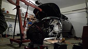

When it's warm again and hopefully a bit more time to work on it, I'll tear back into it and do the clutch/flywheel right. Until then, here is the hole from the inside of the trans. I'm handing it off to a good friend of mine to weld for me. Inside of the trans looks great from what we could tell! No chipped teeth.
