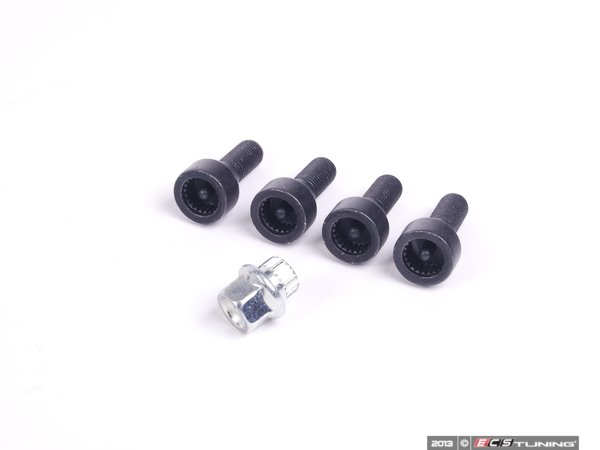

Here is the paper main manual for your April of 2006 production :
Owner's handbook R50, R52, R53 09/2005 to 09/2006 English
http://www.ecstuning.com/Search/SiteSearch/01410159801/
If you need any others I can look them up.
And for the wheel lock there are two different version , most people don't know about the multiple tooth version ( which the key can be found seperatly ). The year split in the lock were 7/2006 when they changed the size of the bolts.
For MINIs up to 7/2006
Wheel Lock Set W/ Lug Key (M12x 1.5) Multiple tooth , which based on the key code a new adapter can be found.
http://www.ecstuning.com/Search/SiteSearch/36130401249/ES65608/
http://www.ecstuning.com/Search/SiteSearch/36136799575/
I could not find the key itself for those types.
For MINIs up from 7/2006
Wheel Lock Set W/ Lug Key (M14x1.25) . which based on the key code a new adapter can be found.
http://www.ecstuning.com/Search/SiteSearch/36136776076/ES65849/
http://www.ecstuning.com/Search/SiteSearch/36136792850/
I could not find the key by itself for those types.
If you need to take off the flower pedal type, you might be able to get them off lug nut removals. I would check the interior of your MINI again for the wheel lock keys , might be in the trunk tool set ( under the carpet section ), center armrest, or door storage area.
