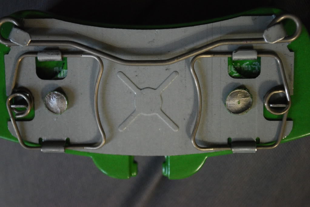

yes its part of the pads.... also make sure to slobber antisieze all over the back of the pads to keep it from making noise. and slober the guid pins while your at it to keep them from seizing. its happend to me multiple times. then i used silver antiseize and it works flawlessly i dont have seize claipers anymore and the pads dont make squeels.
oh only the rears have these clips. and you HAVE TO MAKE SURE THAT ALL THREE SPRINGS ARE IN!!!!
