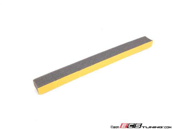

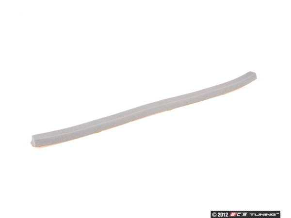

Here is the foam that goes around the radiator and the part numbers. For the Cooper S. I have seen these deteriorate and fall off over time some people don't even know they are missing them. They are peel and stick.
Diagram:
http://www.realoem.com/bmw/enUS/show...20#17107515479
#2 in the diagram
Upper Foam Seal Part # 17107515479
http://www.ecstuning.com/Search/SiteSearch/17107515479/
Lower Foam Seal Part # 17107515480 Diagram #3
http://www.ecstuning.com/Search/SiteSearch/17107515480/
Diagram:
#2 in the diagram

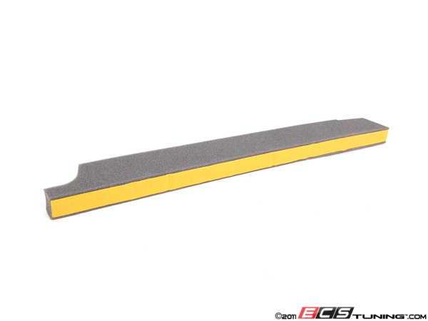

Here you go : In the diagram #3
http://www.realoem.com/bmw/enUS/show...64#51717042998
Gasket Front Panel Seal - Right Part # 51717042998
http://www.ecstuning.com/Search/SiteSearch/51717042998/
Gasket Front Panel Seal - Left Part # 51717042997
http://www.ecstuning.com/Search/SiteSearch/51717042997/ES128687/
