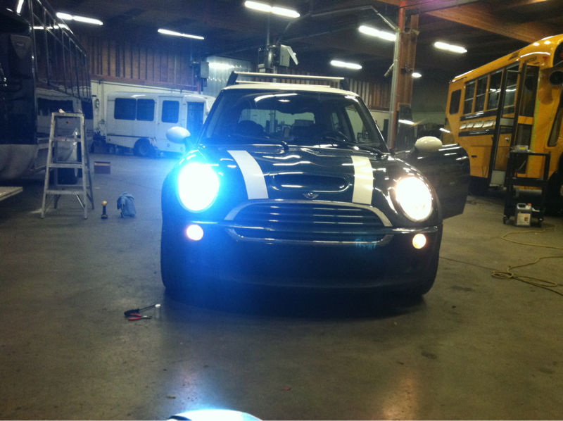

Ok I got the issue fixed by buying the harness with inline compositors. This was a little more involved than I had anticipated!!! But it's done and the end results to me are rewarding!! I tried uploading pictures but it said something about the running software is old or something like that so ill have to wait on the pictures, sorry!
Attached Thumbnails Aftermarket HID issues, anyone else have this problem?-image-3095161517.jpg   Aftermarket HID issues, anyone else have this problem?-image-1363998063.jpg

Ok hope this works!!
Attached Thumbnails Aftermarket HID issues, anyone else have this problem?-image-1578022962.jpg   Aftermarket HID issues, anyone else have this problem?-image-1701449309.jpg   Aftermarket HID issues, anyone else have this problem?-image-2518563474.jpg

maybe it's ur camera but those are really blue for 6000K

Yes I agree, they are more blue than I wanted but they were in a 6K box but who knows if they got packaged wrong?

I'd be willing to bet that's the case.. I'm runnin 6000k in one of other cars and they look OEM in comparison to those..

So. Much. Glare. :(

Yeah as others have noted you are throwing a lot of glare. 6000k looks a lot bluer on camera than it really is. Beam pattern isn't bad from a few feet...pull back about 25 feet and I bet you light up the top of the house....but maybe I am wrong.
