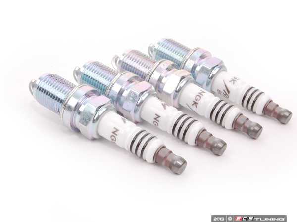

NGK plugs are:
Stock-BKR6EIX
1-cldr (15 or 17 % pulley)-BKR7EIX

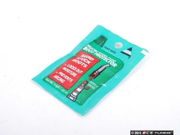

+1 for the OEM coil. Just make sure you apply some die-electrical grease between the spark plug wires and the coil. Saves the coil from getting the rust on the ends.
We have full ignition kits that include the grease or you can get it on its own.

NGK BKR6EIX
Dielectric Spark Plug Boot Protector

Get NGK 4285 if you have a supercharger pulley. These are just like the facotry 4 prong plug ad are Iridium and are one step colder.

The standard plugs are NGK bkr6equp, you can buy iridium ones (BKR6EIX) the gap should be .032" or 0.8mm. But are you using 4 prong or single.

stock style OEM plugs ( for the JCW ((or a S with a pulley..the ones one step cooler)) or the S)are multi pronged....NO gaping.
Make sure you get plugs for the S
The folks that have destroyed a motor have gotten Sparkplugs that are too long.(a guy trued using E2 or some of the NEW, burn 20% less fuel green plugs,,,).not all databases are right when looking for mini parts. So check in more than one place.

Get NGK 4285 which is 4 prong and one step colder if you have a pulley on.
