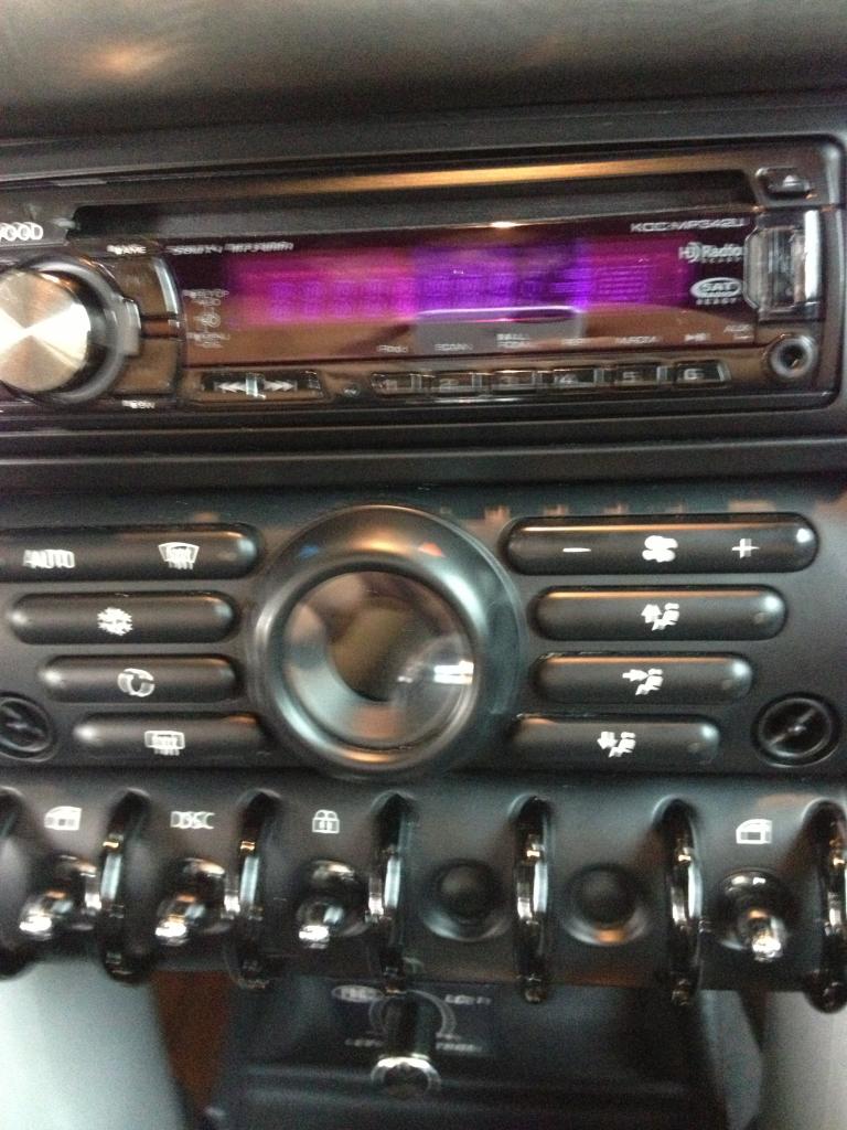

On the topic of the front, Right below the fog light is like a open socket? I do not know what i could put there but i would love something other then emptyness.
Like another light possibly or.. I am open to suggestions cause personally i am clueless.

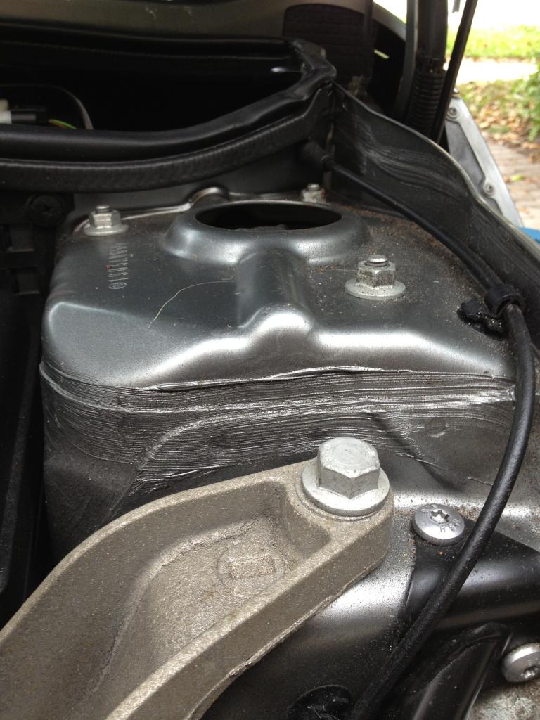

I heard about the to topic of mushrooming and did lots of research and i believe my struts are mushroomed..

You'll need to get a new switch bank or toggle bank, that why you are missing bottons those are the rear and front fogs, if you decide just to get the fronts you still need the new toggle bank or whatever they call it its not cheap but not crazy expensive.
You can also get the rear fog ligh then you will need to have it coded at the dealer or someone that has the software.

Can't really see the mushrooming, but the barbaric 2x4 and sledge is how I did it
As said before, the empty toggles are for front and rear fog lights

This is the toggle switch bank, http://www.ecstuning.com/Mini-2005-C...ches/ES167631/

On the strut towers I hear that is the way to go hammer and mallet weird right?

The rear fog lights can be a little confusing: Also with the addition of the front fog light add on.
Depending on options and year corresponds to the toggle panel you will need.
There was a wire kit that was needed for certain years because MINI decided to not install them from the factory for the ability of the fog light option, which was due to the west coast states dragging there feet on the legality of the rear fog light.
Rear lens : Part # 63247166015
ttp://www.ecstuning.com/Search/63247166015/ES2207526/
Rear fog light wire kit: part # 63120406620
http://www.ecstuning.com/Search/63120406620/ES172109/
Wire kit:
***For vehicles built from 7/2004 - 11/2004.
Since some production cars might have factory wiring, please check under the rear bumper near the center on the body for rear plug harness.***
:::::Toggle switches::::::
9/2004 was the split year. For the R50 R53 model.
http://www.ecstuning.com/Mini-2004-C...rior/Switches/
First what does the toggle back look like. There are six switches.
For example:
From left to right:
All MINIs have windows / locks , so the "DCS or ACS or blank" for the one between the lock and driver window.
Then Rear fog light option , then front fog light option , then window switch.
Determine production month / year and you should be good to go. Toogle - "Rear fog light " section is for all toggle combinations that include the rear fog light.
Install PDF for rear fog lights pre 7/2004
http://www.motoringfile.com/howto/Fog%20Lights.PDF
Here is the front fog light add on kit for Gen 1 - 63130395387
http://www.ecstuning.com/Search/63130395387/ES173352/
This will require the corresponding toggle back with your options. Its easy to just let me know what you have and what you end up doing .
