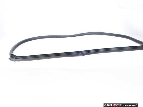

I mentioned how to align and if its straight and not too high, its likely the seal.
If your window is straight on the seam with the B - pillar, then you can get a new seal. IF not then you can adjust it with a tool. A MINI dealership or anyone with the ability to align panels can do.
Bpilliar between #2 and #3
For adjustment
*There are two mounts on the bottom of the window at the meeting of the regulator to the glass , they look like little gears and take a special MINI window tool. * Looking at the window on the side of you MINI with the door closed = in essence you can move the window left, right, up , and down by a small amount. But not toward on inward to the car. * Unless you are able to do some mechanicals I would leave this to someone who can repair windows.
Or if its straight: You can get a new seal , we have them here.
OEM MINI Part : 51767151383 Left ( passenger side ) Fits All R50 R53 & R56 hardtops
Thanks and I hope that helps, let me know if you guys need anything else.
