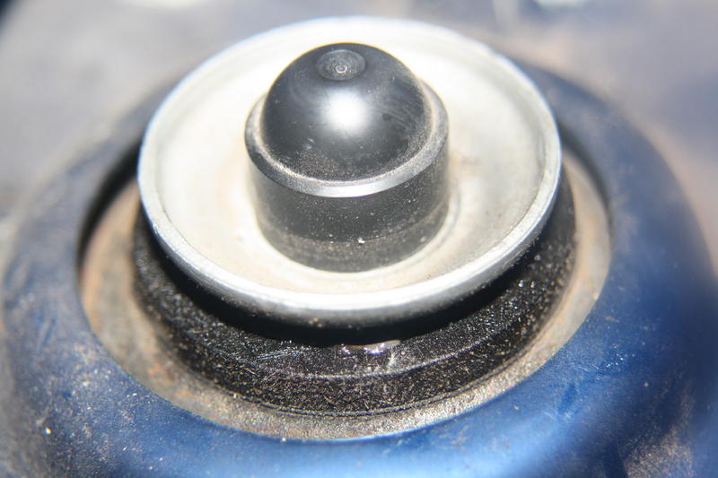

Here's where I got puzzled; looking at the threads about strut mount failure, I looked real close at my mounts and they do not look like anyone else's I have seen. The only thing I could find in my paperwork was something listed as recall 51 03 03 that was performed when the owner complained of wheel and tire concern.
This mount is all steel, with only a rubber coating in the middle (for sound deadening?) the bearing must be under the plate because it isn't in it.
My first thought: it must be an aftermarket part but then I found a Mini part number on the strut and it looks old. So this led to all kinds of questions.
1. Why are these different?
2. Should it have been retrofitted as a part of a recall when it was new?
3. It is all steel and didn't punch its way up through the strut towers after all this time, why would they have changed the design to a failure prone rubber one?
4. When I buy struts are they going to fit these mounts or am I going to have to buy new failure prone mounts too?
Anyone know what the deal was here?
How about any ideas about the creaking noise?

No mushrooming at all. That is why I am puzzled. If they already had the answer to the problem, why change the part. I am going to have the front end apart to do bushings, when I do I will lower a strut so that I have a good look at what is going on here. I will post pictures and hopefully it has part numbers that are still valid. Stay tuned
According to my Bentley manual, the upper strut mounts changed in 3/2002. Yours is the older version. The washer on top under the nut is called the "articulated disk", which the newer versions don't use / have. The upper spring seats are different, too. I'm not sure if the mushrooming / cracked upper strut mounts are only applicable to the post 3/2002 mounts, but digging through the endless threads on these two issues may yield the answer (I suspect that is so, as you haven't experienced any mushrooming with high mileage).

Yes, it does have 15"s, oddly enough though, I got the window sticker with it and it said the car was supposed to have 16" runflats on white painted rims. The car actually has 15" silver 5 spokes on it, which I prefer, reminds me of the old Minilites from the '60s. I am the second owner and got all the service records with it, I didn't see anything about a wheel swap but whatever.
This should prove interesting...according to a dealer parts page, that part number in the photo was used on cars made from 9-'01 to 3-'02, wonder what the odds are of getting an aftermarket strut to fit that mount are.
I have noticed that sites like Rockauto show parts listed for 2002 as production 3/'02 on. I wondered why, now I guess I know but they don't have earlier listings in their catalogs...as if they weren't made before then.

and the mounts were different for 9/01 - 3/02 compared with later cars.
You can change the whole works to the later parts, but not piecemeal.

While I had everything apart, I got out my spring compressor to look at that mount.
Here is what I found...Mini replaced one crappy design with an even worse design.
Once the tie rod was disconnected and I was free to rotate the strut, I could get the pop sound to repeat over and over. I noticed the spring was moving slightly every time it made the noise.
I took the mount off and then it was obvious..the bearing upon which the spring rotates was supposed to be held in place by three tabs and now wasn't. The only thing that was supposed to keep bearing in was the tension of the spring. The bearing was doing a see-saw motion on two of the tabs and that was the pop noise. I would guess that at some point the previous owner either hit really deep potholes or was trying to re-enact "The Italian job" and the spring jumped out of the tabs.
I used some urethane adhesive under the bearing and on the tabs after I cleaned it really well and after I got it all back together, the pop was gone. All it would have taken was three riveted tabs to keep this from happening in the first place. Both sides were this way, but on the bright side, at least the strut towers aren't mushroomed.
Now before everyone jumps me saying that I should have just got new struts and mounts, remember I took it apart for the bushings and just wanted to look it over because mine was the odd ball. Besides, I already dropped a couple hundred.
