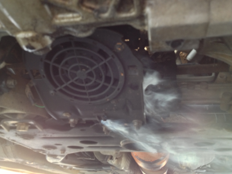

Get out if the gym, start the car up, turn on the A/C and wait for my wife's text. As I am waiting, smoke starts to billow up from engine bay. Smelled electrical. Shut the car off and inspected. Restarted car and found smoke coming from PS pump/fan (see pic). Steering appeared to be normal. So i leave the car sit for a while, restart it, and nothing.
Anyone else have this happen? Any ideas if fan or pump are about to go?
Btw, it's a 2005 MCS with 140,000 miles. I believe it's the original pump.

I would wager your fan is froze up with grit. You need the ducting to cover this as it will extend the life of the fan and prevent your car from bursting into flames.

unplug the fan ASAP
Next..order a new one, and replace it.

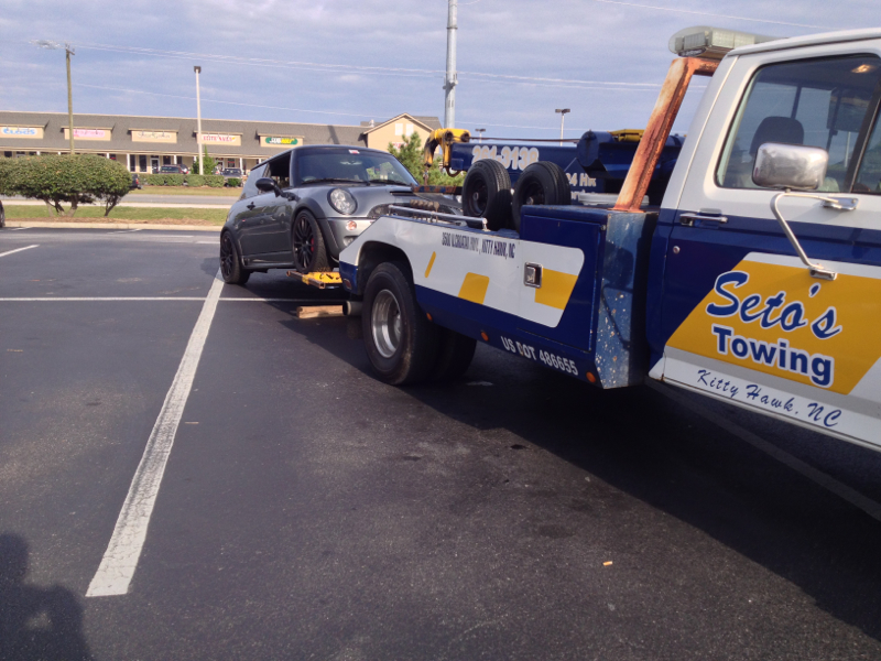

Old Oct 19, 2012 | 11:08 AM
MYT MSE's Avatar
MYT MSE
Joined: Feb 2012
Posts: 192
From: OBX, NC
Thanks guys. Got the tow truck on the way.
