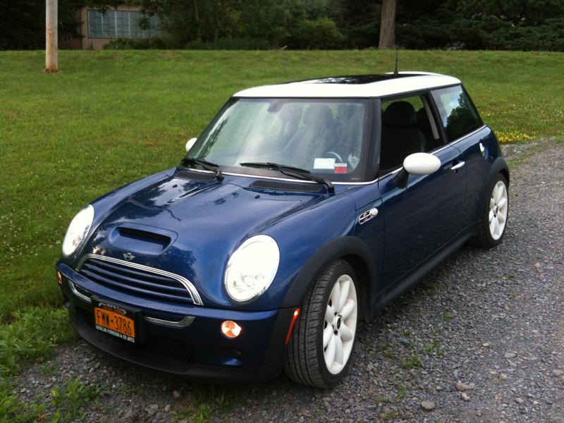

You have my dream color combo, and those white rims just set it off nicely!
( wife's car is black on black)
