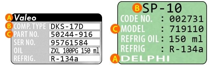

Hey everyone ... good discussion. I've attached some instructions for compressor replacement from All Data.
Words of caution when it comes to refrigerant oil. Some compressors are shipped with a complete system charge of refrigerant oil; some are not; some say the are (but don't have any oil in them.) The last compressor I changed in my 2012 R56 says it was filled with 6 oz of oil. When I removed the caps from the ports to drain the new oil. Nothing came out; the compressor was shipped dry, but the label said it had 6 oz in it. Always drain your new (or used) compressor and measure the oil.
Now when it comes to components, condenser, receiver drier (part of the condenser on gen 1 and gen 2 MINIs), evaporator coils etc. You will want to drain the removed component, measure the amount drained, and then add that amount back to the system. If you removed the condenser and drained 1 ounce out, add 1 ounce to the new condenser.
If your compressor has failed, you will need to replace the condenser coil (with the included receiver dryer), and flush the evaporator and lines. Failure to perform and AC system flush after a compressor failure may result in damage to the new compressor. Drain the new compressor and measure the amount of oil. Add new refrigerant oil in the amount that is specified on the compressor label. The reason you guys can't find a spec for how much refrigerant oil goes into the system is because the service manual says to reference the label on the new compressor.
According to the MINI service manual, it says you do not have to change the desiccant bag (receiver dryer) if the system was open for less than 24 hours, but I would say that anytime you have the system open, change it and plug on the bottom of the condenser (the two parts normally come together.) The plug as a fine screen on it that will trap contamination. Contamination on the filter plug screen and the desiccant bag can cause excessive high-side pressure; insufficient low side pressure, insufficient refrigerant delivery to the evaporator coil, and overall poor AC performance.
As someone already stated, automotive AC systems are designed with a certain amount of refrigerant oil, and a certain amount of refrigerant, so there is not need for superheat calculations like techs perform on your home AC system. Failure to service the system with the correct amounts of refrigerant oil/refrigerant will probably result in poor system performance and may cause component failure. If you're not trained on how to perform this task, get some training, get a buddy who is, or take it to a shop.
Now if you go to RockAuto.com and shop for a new compressor, click on the "info" icon. There you'll see a picture of a sample compressor label.
Here's are two such samples for an '06 R53. Notice how both brands of compressors say 150ml (5 ounces). That's a full system charge.
