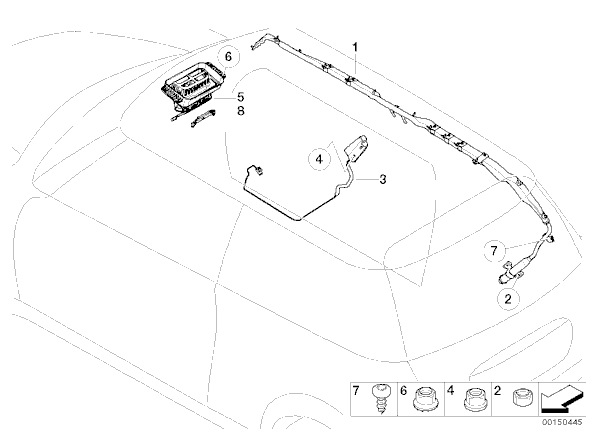

the 2005 does have side/curtain airbags. The seats contain the side airbag and the curtain aibrbags will deploy from the headliner. The seats say airbag, the steering wheel and the dash in front of the passenger say airbag. It only makes sense the curtain airbag is somehow connected to the a-pillar trim that says airbag.

Here is a diagram of the airbags in the MCS.
