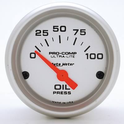

Another thing to think about when considering electrical versus mechanical gauges is that mechanical gauges usually have 270° (or more) of sweep, like this:
While electrical gauges usually only have 90° of sweep, like this:
Note that both gauges cover the same range (0-100 psig), but the electrical gauge can be harder to read accurately, since the range is "crammed" into a smaller sweep.
There *are* full-sweep electrical gauges, (like PARTSMAN's oil and temp gauges pictured in his post above), but the price jumps up considerably. For example, an Autometer mechanical boost gauge is about $60, while their equivalent size/range of electrical boost gauge is closer to $200. (Strangely, they don't seem to make a 90°-sweep electrical boost gauge, so it looks like the $60 mechanical or $200 full-sweep electrical are your only choices from them.) For most gauges (oil pressure, water temp, etcetera) you have the choice of a 90° electrical version for not much more money than the mechanical version, if precise readings aren't important to you.
