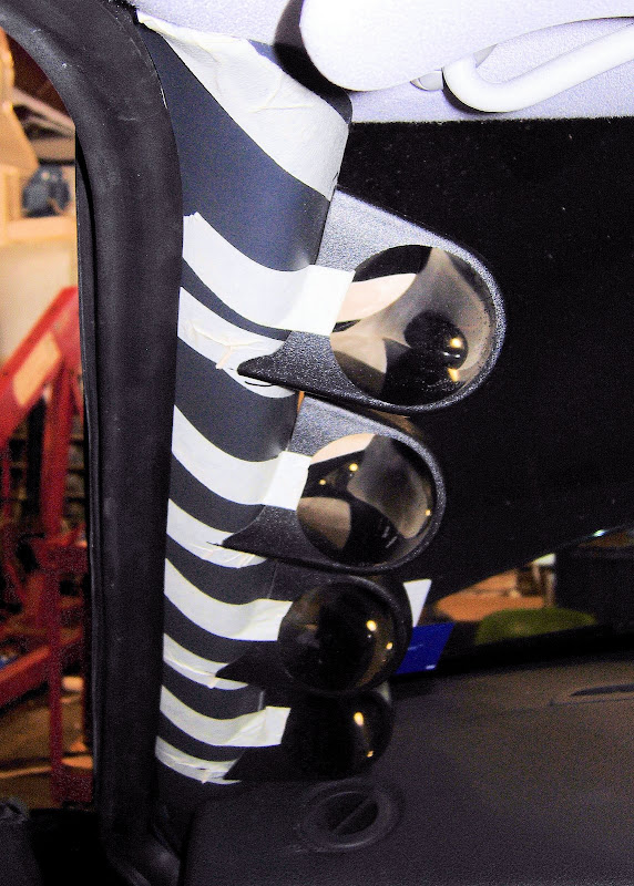

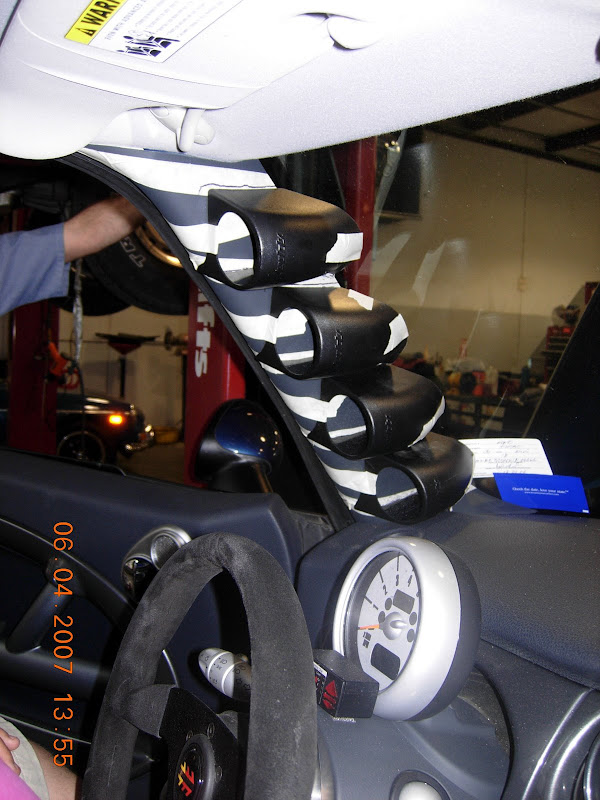

To avoid the gauge clutter around the steering wheel and keep the G2X dash display visible the other gauges are house in a custom built A Pillar. Starting with am OEM pillar generic off the shelf 66mm pods were fitted, The picture below does not due the detail and finish of the pillar justice.
Sitting in the drivers seat the pillar is not as bulky as it looks in the photo. The front section visible through the windscreen is also finished to a very high standard. The back of the G2X Dash display is also shown here.

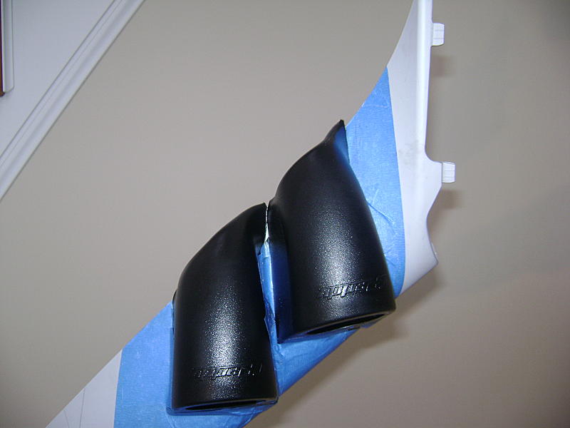

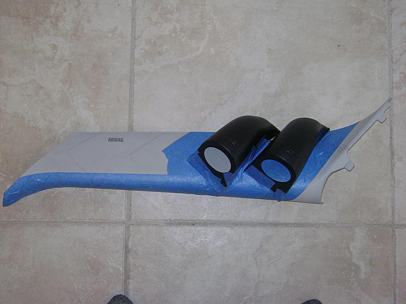

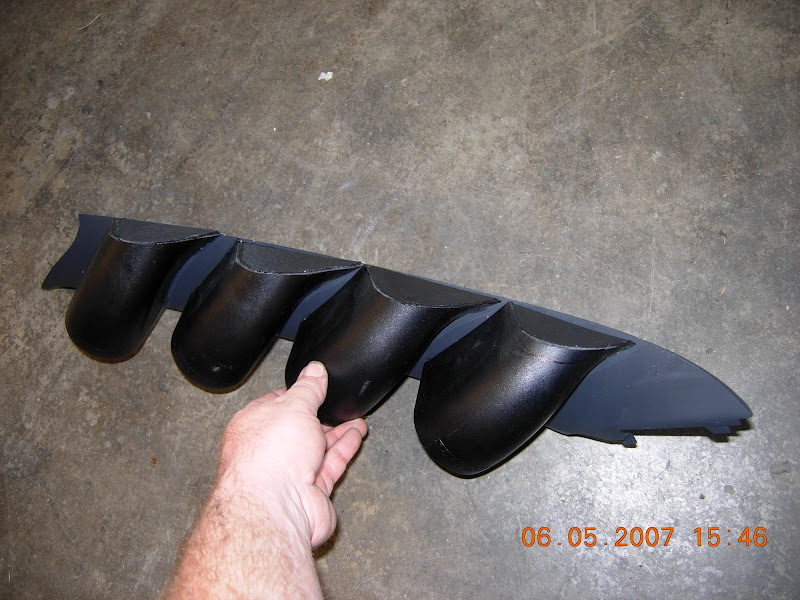

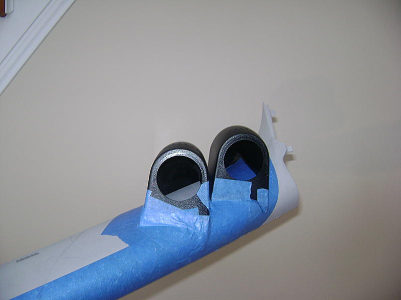

It's not hand made fiberglass. We took an OEM pillar and mated 4 generic Greddy A pillar cups to it. The gauges are 2 5/8" or 66mm and the largest cups we could find were 60 mm there was some relief work in that area as well. The Craven cups required a very light pass with emory cloth to remove the interior anodizing and the gauges were still a bit of a tight fit, they won't be moving around.
We started off with these:
After some intial trimming this is a mockup to see how placement would work.
This will give you some idea of the amount of trimming reqired.
The entire rear of the pod had to cut off and new ones fabricated.

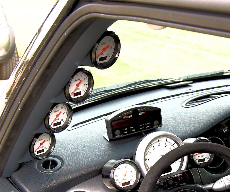

This is the best shot I currently have of the finished product.
From top to bottom.
Volts
Air/Fuel Ratio
Boost
Oil Pressure
In the Craven pod
Water Temp
Oil Temp

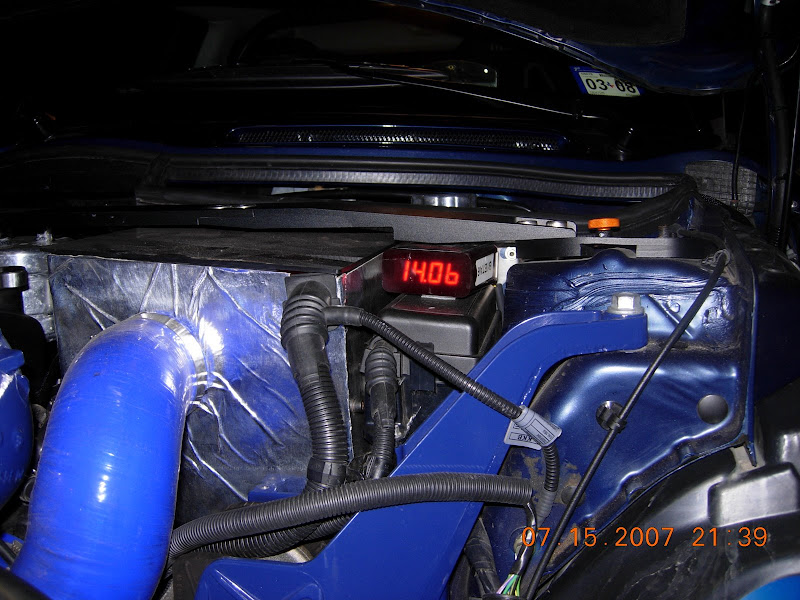

Along with the analog type needle there is a digital readout located in the lower face of the gauge. The A/F R kit also contains a module with a digital readout that was placed under the bonnet. This allows for live readings during dyno testing. As stated in the first post all the data is also logged via the G2X brain on a CF card. A 512MB card, the upper size limit the unit can handle, will hold approximately 25 hours of data. A 25 min track session took just over 1MB on the card.

Under Bonnet A/F R display. This is part of the A/F sensor kit used with the Racepak gauges.
