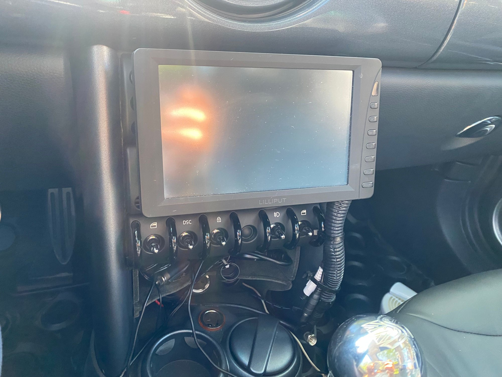

I just bought an R53, and there was a 7” monitor connected to the mounting point for the cup holder. I figured I’d take it out when I brought the car home. On picking it up I saw it was wired to a Mac computer in the glove box and had a wireless keyboard in the seat back.
I can’t figure out how to power it on…or the stereo which must be connected to it. All I wanted was a grom unit so I could play music through the stock head unit on an hk system! Now I need to figure this out or how to undo it. Any idea where to start?
it seems to have extra lighter plugs wired in and a toggle switch n the glove box. Again, no idea if this is connected to the battery or what but the Mac doesn’t turn on.

Good grief, what is all that? Was the previous owner an independent contractor for the SETI institute, haha.
Doesn't look to hard to take it all out and start fresh.

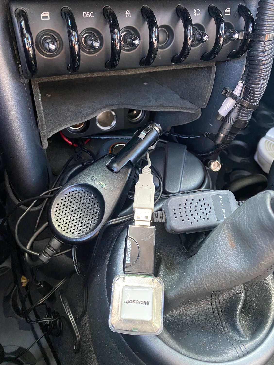

I looked under the steering column and have no idea what’s in there. It’s frightening. Can anyone tell me what the black one is (maybe a old garmin) and what the cut red and blue wires may be??

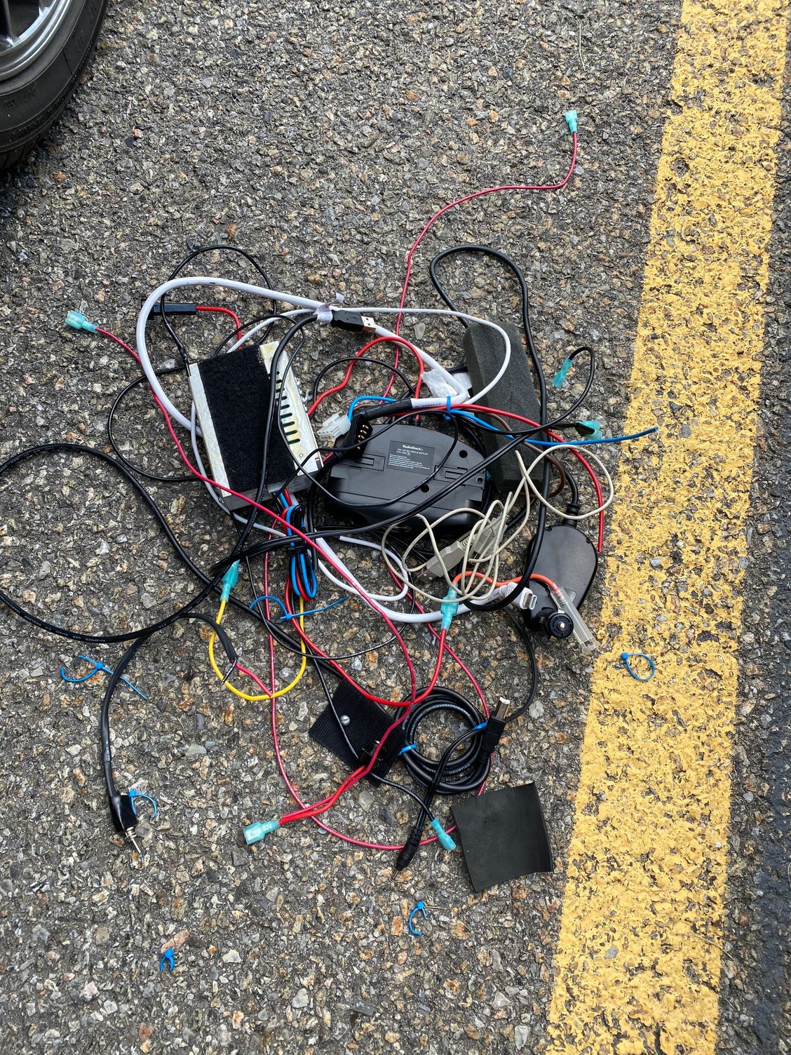

I pulled out 4 long usb cables, a giant antenna, huge garmin plug…it’s crazy the bag of stuff that was in there and still is. Some things are more obscure than others and well done so hard to tell what’s oem. Either way, it’s really dated and I’d love it gone. I just don’t want to cut anything unless I know exactly what it is.

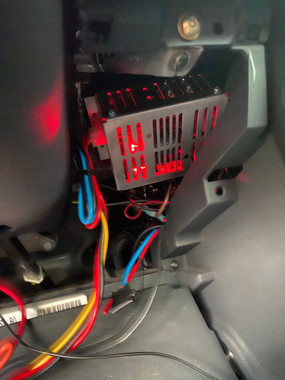

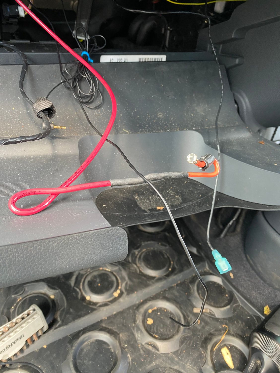

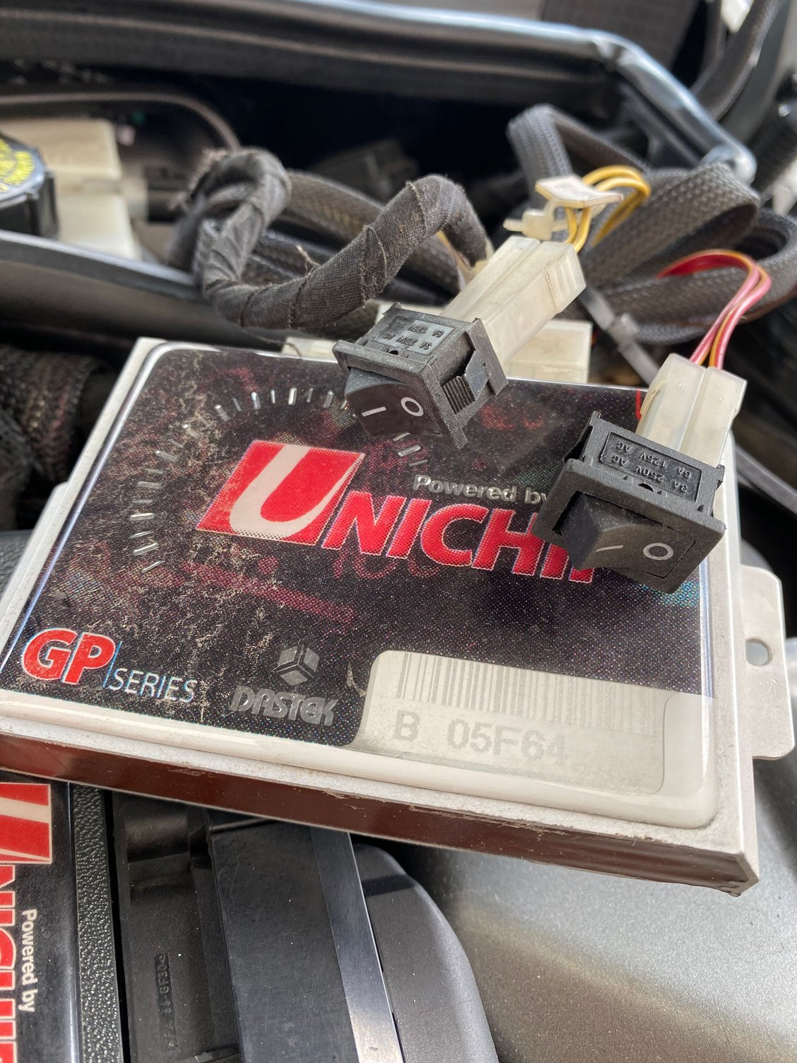

Update - I took some time at lunch…. The red light in the box with the car off might be a culprit for the battery suck. I got all but 3 cables out. Red line is connected to the battery. Orange is ?? And some cut black line..: there are 2 that drape down from the radio but presumably one is interrupting the stock connection which is why the radio doesn’t power on. I’ll get back there when the BlueMusic arrives to be installed. I kept the mic that’s wired. That’s something. The Unichip piggy back is the next thing to figure out. 2 switches and both off. Maybe one is to turn on the CEL and the other is go faster.
