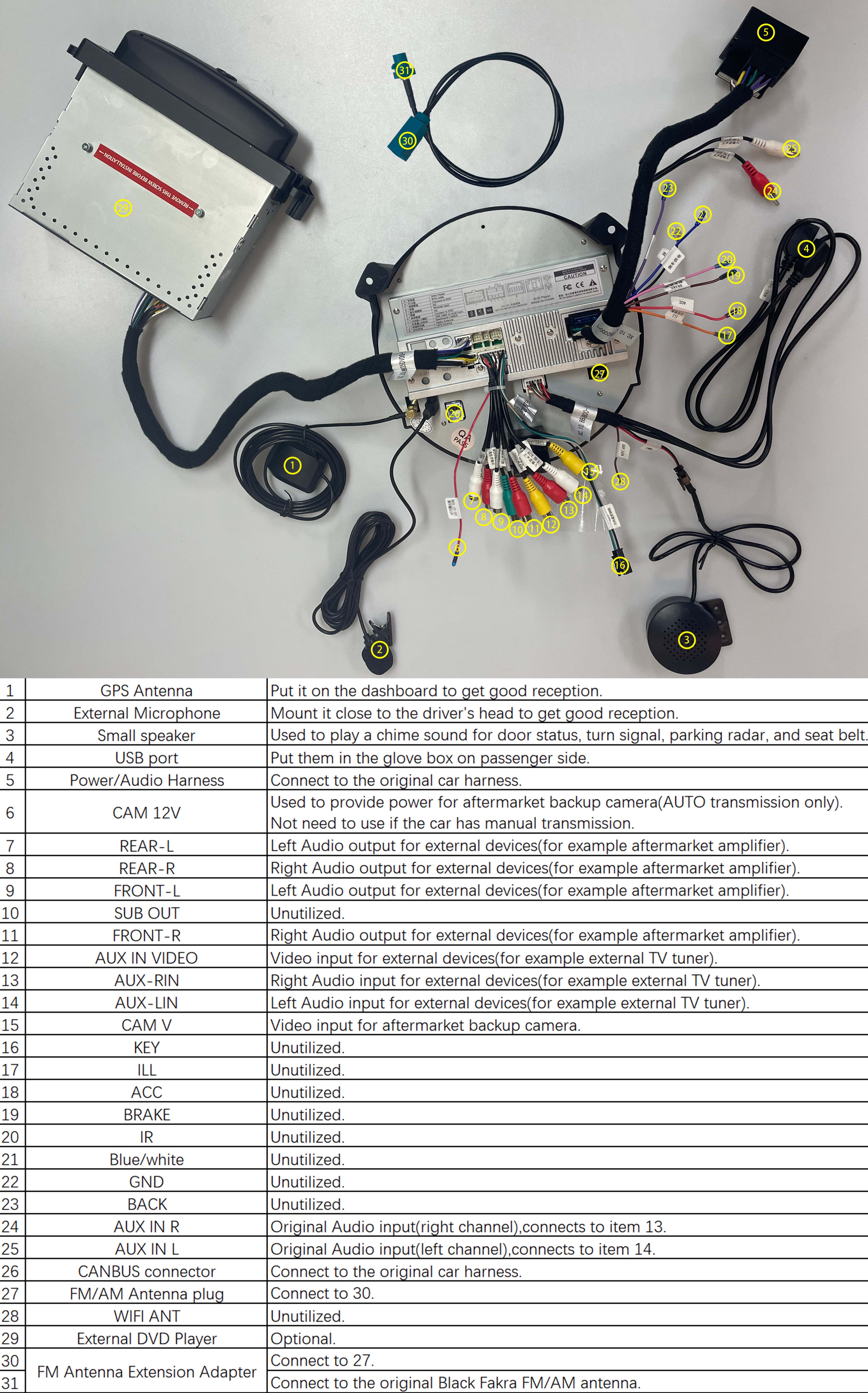

Just a quick update:
1) Upon a little more thought on the Kicker subwoofer install, I am going to use the mono subwoofer out RCA ( with a y adapter ) vs using the Rear RCA pair. Even if this is what Kicker advised, the reason being the RCA Rear outs are tied to the equalizer and don't want this tied to the subwoofer, as I need to tune the bass out in the Front/Rear independent of the subwoofer. As an FYI - when I mentioned this to Kicker, they said that using the equalizer would not impact the subwoofer if using the Rear RCAs. Does not make sense to me ( or Crutchfield ... ).
One note - when I was exploring the Carnaviplayer unit, they told me that their subwoofer RCA is not active:
You can not add a subwoofer to this unit because wire 10 is an empty port.
Best regards,
CarNaviPlayer Support Team
www.carnaviplayer.com
I did verify with Bremmen that the subwoofer RCA ( 7 in the diagram ) is active and has 0.8 output voltage with cross over freqs at either 65,80, or 100 hz.
Find attached their wiring diagram for those interested.

Backside of my unit: https://www.sigmacarstereo.com/docs/...5-backside.jpg
Hookup and wiring diagram: https://www.sigmacarstereo.com/docs/...835_LRG_09.jpg

You are right - the back look the same. I was just looking at the numbering schemes.
We will see on the subwoofer out. I was actually given specs from the Bremmen Tech guy, so am hoping it is live.
And it is listed as an output on ECS's website.

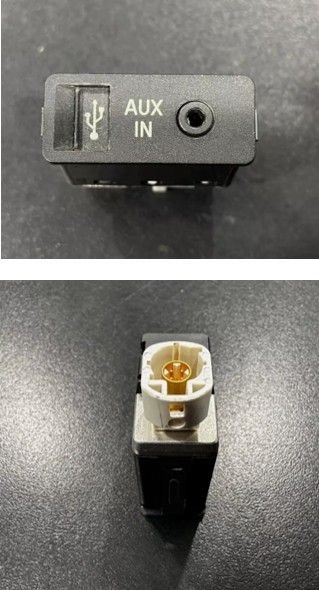

If you have the USB/Aux ports in the center dash they won't work after the new radio install. The new radio has two USB-A female cables. Rather than run both those out of the dash, hook the adapter cable up to one of them and plug the green connector into the dash USB port: that'll give you easy access to a port and a nice, clean install. It may only be USB2, I dunno, but that should be all you need for most stuff.

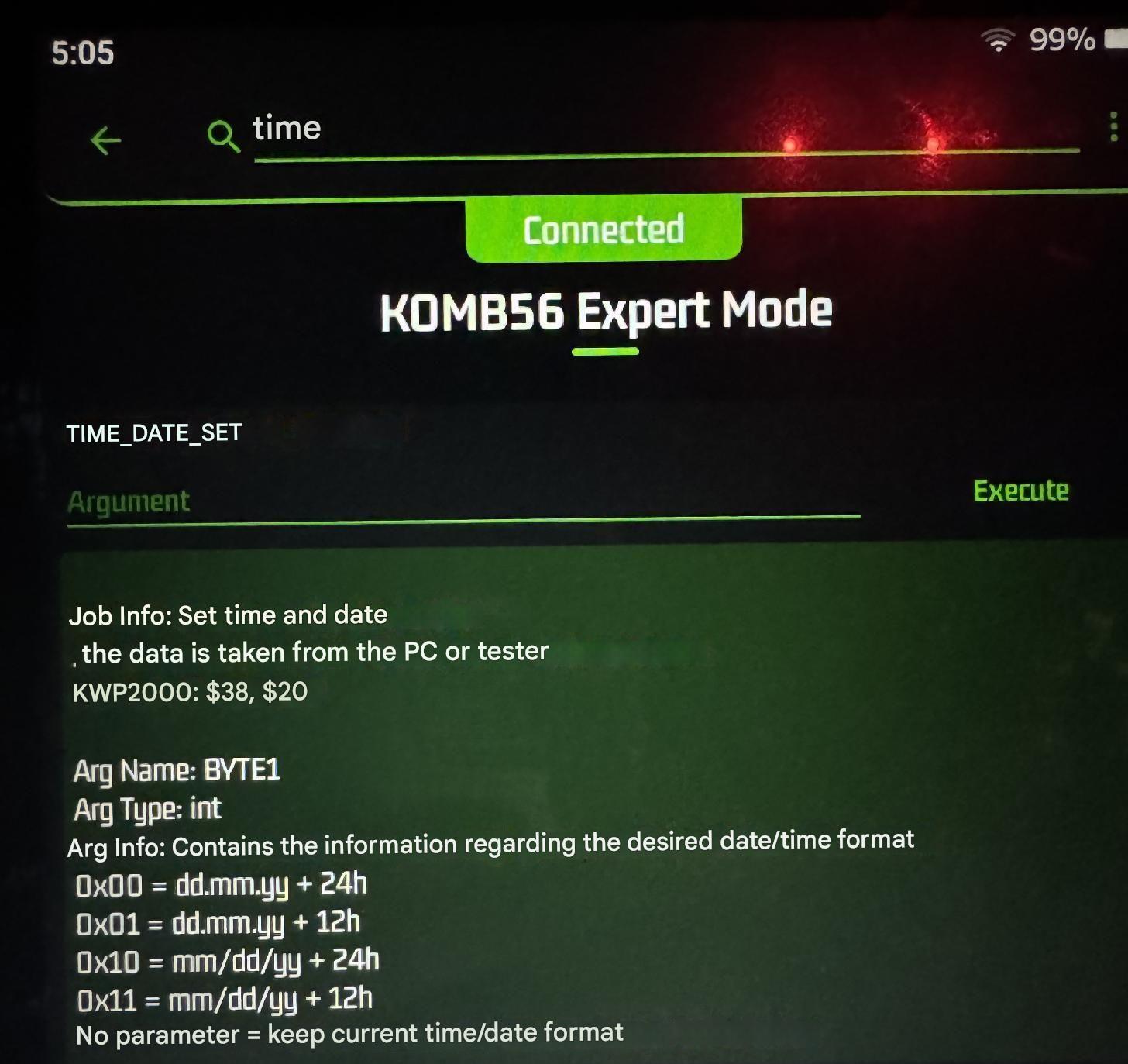

That reminds me: I usually ProTool to do coding on the Mini, but with the Android radio installed it would crap out and not work. The radio is on the Canbus and apparently it confuses ProTool. I had to pull the radio fuse and then ProTool worked fine. NCS Expert worked okay with the Android radio powered.
I think of anything else I'll let you know, this stuff is all reasonably fresh in my mind.

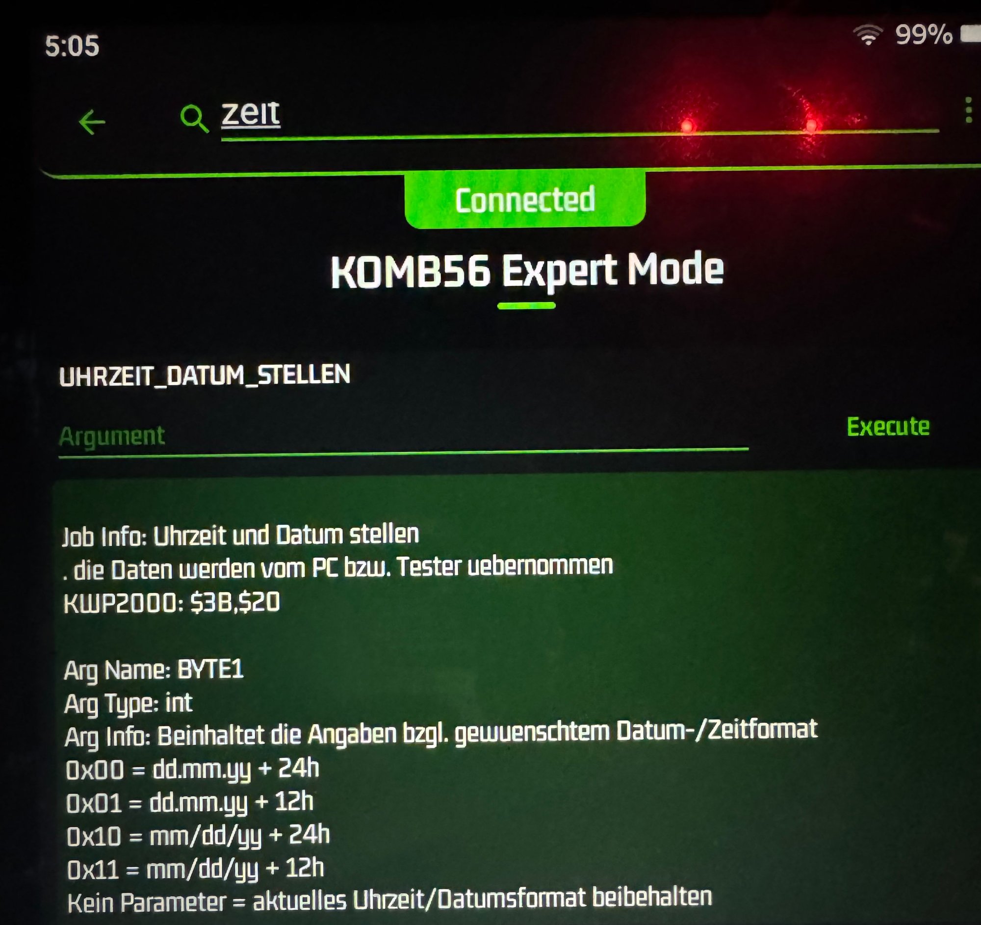

Found the screenshot I took to remind me for next time. This is the job in the KOMBI (instrument) module to set the date and time in ProTool, BTW. It's in expert settings which is why it's in German. Executing this job sets the date and time using the values on whatever device you're using (Android tablet, in my case).
For ProTool to connect you need to pull fuse 45 to cut power to the new radio.

In English. Just leave the argument blank and hit "execute".

I purchased a new USB/Audio in adapter that had the USB C plug and RCA connectors, replaced my existing plug in the cubby hole.
I think it was you that replied to my post in BimmerTools forum about pulling the fuse to get it to work. I hadn't thought of trying that. I was getting close to my 30 day period and couldn't get it to work so requested and received a refund from them, I no longer have it. I got it to program the JCW big brakes on my car. After much research trial/error, I figured out how to do it via NCS Expert.
First time I was taking my time labeling and being careful. Since then I did something else in the radio compartment and had it apart/back together in two hours.
Yes the vent Torx screws were/are a total PIA to get out/in.
I did do a backup camera when I did mine. That was the other reason I purchased one. If you every drive a R58 Coupe and try to back, other than your side mirrors, the rest of the back is a blind spot.
ISTA wasn't that hard to learn and worked fine for the clock reset. I saved instructions on how to do it every Spring/Fall.

2) @Gubi - For the USB adapter cable in the Amazon link
"Oh and also get a USB adapter cable if you have in-dash USB! I got this one and only used the cable portion:
Amazon Amazon
Amazon Amazon
If you have the USB/Aux ports in the center dash they won't work after the new radio install. The new radio has two USB-A female cables. Rather than run both those out of the dash, hook the adapter cable up to one of them and plug the green connector into the dash USB port: that'll give you easy access to a port and a nice, clean install. It may only be USB2, I dunno, but that should be all you need for most stuff."
I think I have the USB port - I need to check. But if I do, just plug the back end of the Amazon unit to the OEM port ( see photo ). I'd rather have USB C - but still cool. Is this what you did @DogfaceSGM ? What adapter did you buy ?

5) Find attached the pdf Bremmen sent - same photos - but customized to my mini
I had the stock mini USB-A and aux ports in the lower center dash. What I did is just run that Amazon cable from the new radio's USB-A port to the existing USB port in the car. The Aux port I just left, it's not doing anything any more.
