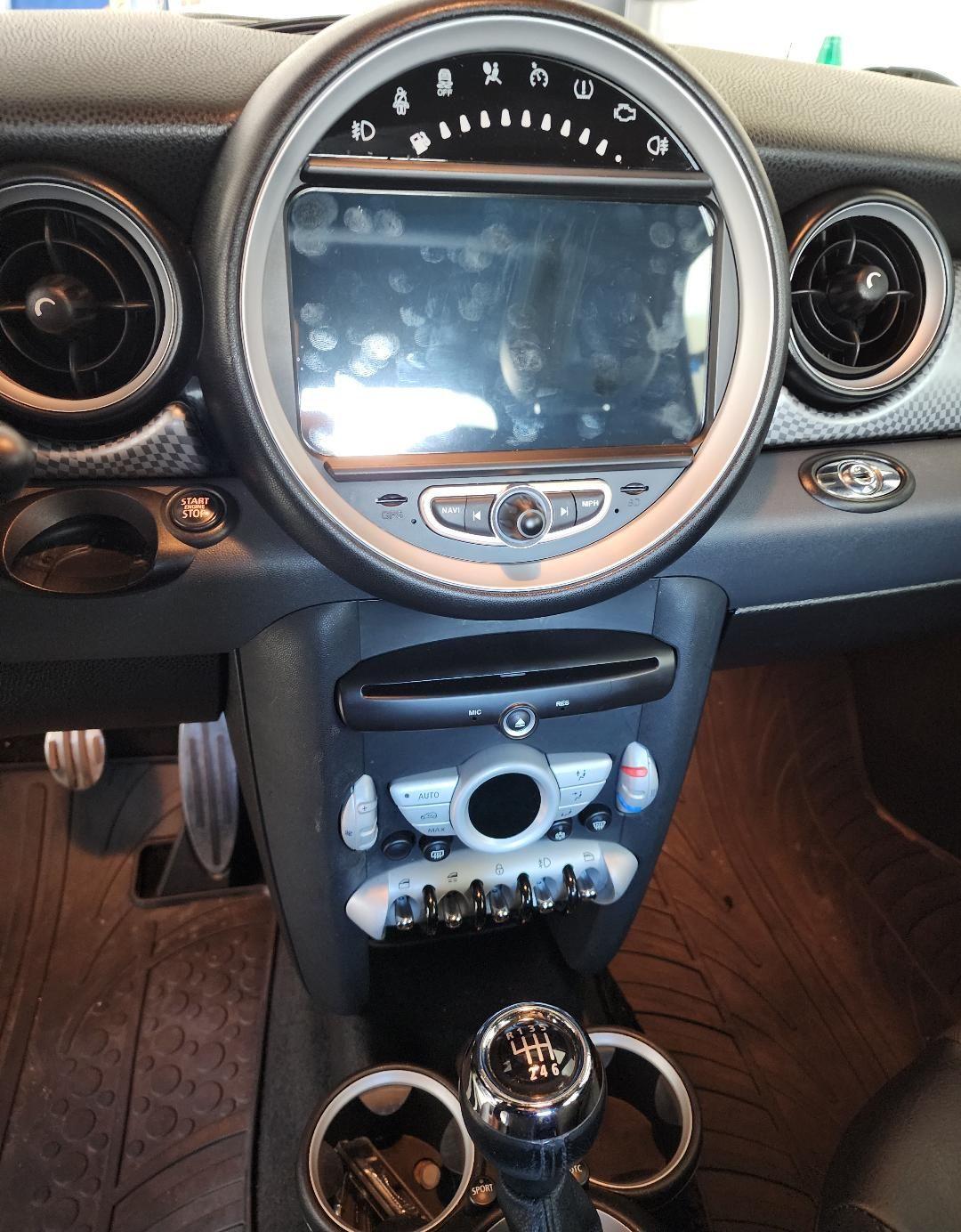

Follow Up:
1) Find photos attached of the install - head unit, close up on area I drilled for AC/Defrost buttons, subwoofer, loc and rear camera
Detail on where I drilled for AC/Defrost buttons
Rear View camera - offset to avoid tailgate latch
Side shot of subwoofer - on the right you can see LOC in the shadow
Subwoofer in trunk - velcro'd in place
LOC on back of the subwoofer - velcro'd on
Andriod Unit installed
Android Unit installed

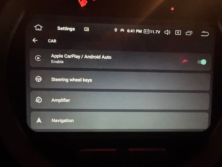

Hi - I went into Canbus ( see photo ) - do you recall if this is your setting - 89 13 BMW MINI (Bagoo) ?
I see there is another MINI setting - - 99 15 BMW MINI (Bagoo)
Or it might be a general BMW setting too. Recall - my mini is a 2010 ( so pre 2011 - which might be different ).
Thanks !

Pretty sure that's how mine is set. I think you want to go to the Key Study menu? Somewhere there's something that lets you directly program the steering wheel keys.

Okay, found it. Go into Settings -> Car Settings -> Steering Wheel Keys. That'll let you program them.
If that doesn't work go into Settings -> Car Settings -> Factory Settings -> Other and make sure steering wheel keys assign is set to Can Key.

That worked - I needed to do both. Thanks so much ! I was a bit finicky in assigning/programming the volume controls - but after a few tries, I got it. You just need to be persistent, and wait between steps to make sure it took.
I'll see if it still works the next time I start the car - as it did not need to reboot.

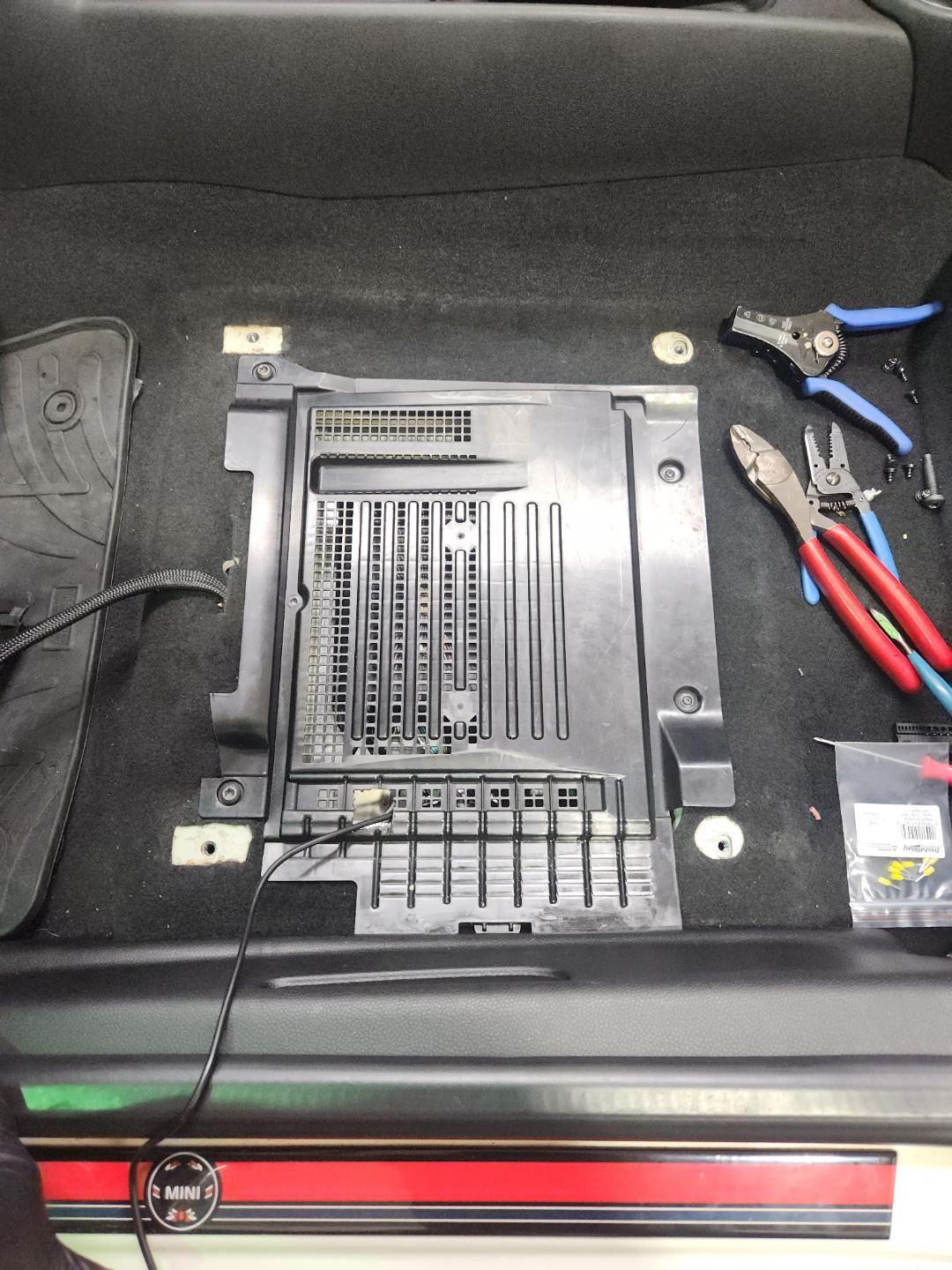

"Tying" up some loose ends on this install:
The Android Head unit was fine - but noticed the volumes were very loud on the FM radio - where I only used about 1/3 of the volume range. The DVD was much better - so could use more of the range for the same 'loudness'.
Unfortunately, I had blown a CAS unit that I needed to be replaced. I had the local Mini Tech ( Matt - in Naples FL ) do it - he is great by the way ! Just does Mini's - from oil changes to engine swaps etc. He has done about 3 dozen CAS replacements. He told me to wait until it is cool and see if the car starts then - it did. So I drove it over when I could get an appointment. He also have better diagnostic software then my scanner and verified it was the CAS and not the Footwell Mod or fuel pump relay. FL is a bit harder on electronics ... ..
Anyway - while doing that, I decided to add the 8 channel JBL/Infinity Amp. I found an unopened box on ebay for $200 - so went for it. Matt said he would like to install it - as he gets lots of requests for stereos and wanted to see how hard it was to do an amp upgrade. It was only 2 hours of work because:
1) We used the HK existing power and ground wires - they were 12 gauge and we would have installed 10 gauge. We ran it for 3 - 4 hours and although the amp got warm, it could be touched. And their were not cut outs - it ran continuously. Others on this forum have done the same.
2) We added a heat sink
3) It easily fit where the stock HK amp was and we were able to use the existing cover with a little massaging.
4) We used the speaker wire inputs - which was the most time consuming of the install. One wire had us fooled - as the color was similar between 2 wires and we guessed wrong.
5) We used the DSP input parameters from earlier in this thread - adjusted a little as I have the subwoofer and did not want any of the woofers doing much work below 60ish hz. I also set the time delays to the center head rests between the two front seats ( in inches )
6) The Input levels between radio, DVD, etc are seemed to work. I have the the Master volume set at 0 - I think max is 6 dB is max, so I have turned down quite a bit. So hopefully good clean power ... Note - I still gets plenty loud !
To set the Input levels go to: Settings -> Car Settings ( code is 318 ) > Voice in the head unit. I set all my settings to 15. Not sure how high they go - I should have checked - but maybe 20.

amp with heat synch under
amp with heat sink under
Amp Covered
Amp Covered
