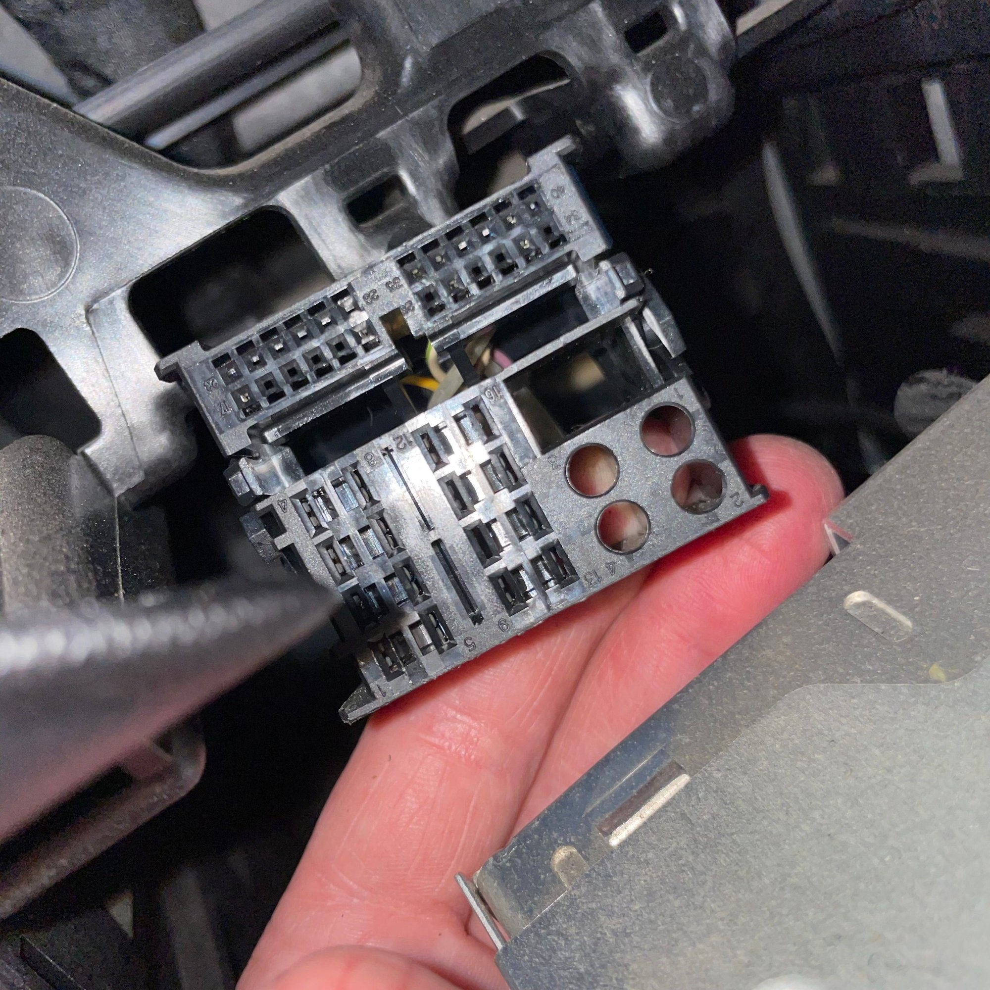

Hello NAM! I recently bought myself an R56 and ordered a head unit the same day I bought the car. I’m loving the car, and when I got the head unit yesterday, I immediately got to work.
One small issue; there was no sound coming from my speakers at all when I did a test run.
I came to the realization that the iso harness that came with the head unit did not have the connections highlighted in the pictures. I’ve messaged the seller to see if they have an adapter. I am wondering if you guys have any alternative ideas so that I don’t have to send it back in the event the sell doesn’t have an adapter.
Excited to have finally joined, hoping I can get some good input.
harness that came with the head unit:
Can Bus connection in my 09 R56
back of CD player/stock unit

I've figure out what the issue is. The head unit's RCA connections are not connecting to anything on the mini's harness. See pics: If any of you guys has any idea as to how I could rewire this myself (which number pins I would have to wire the RCA connections to) that would help me immensely

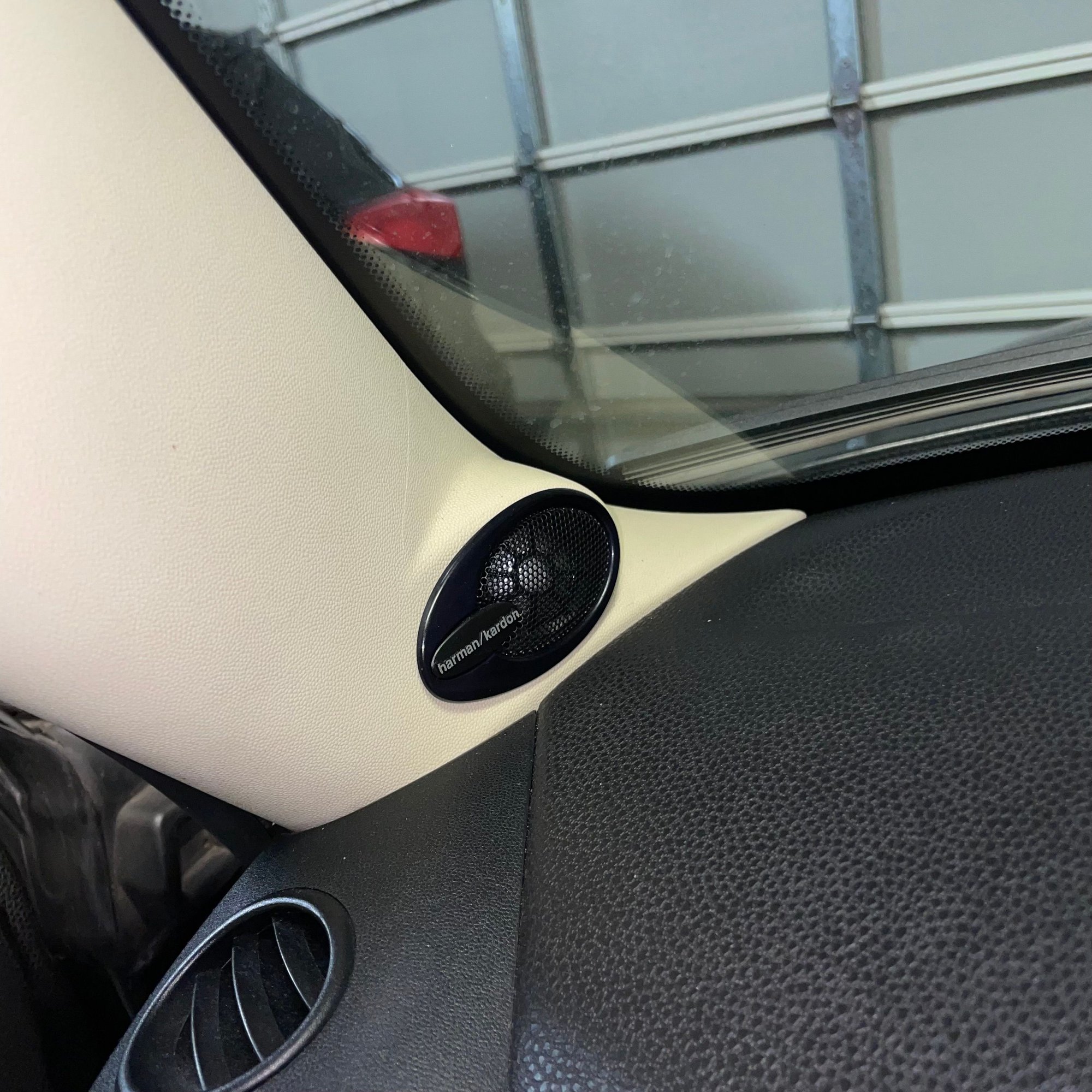

I have the Harman Kardon system but no MOST or optical connections

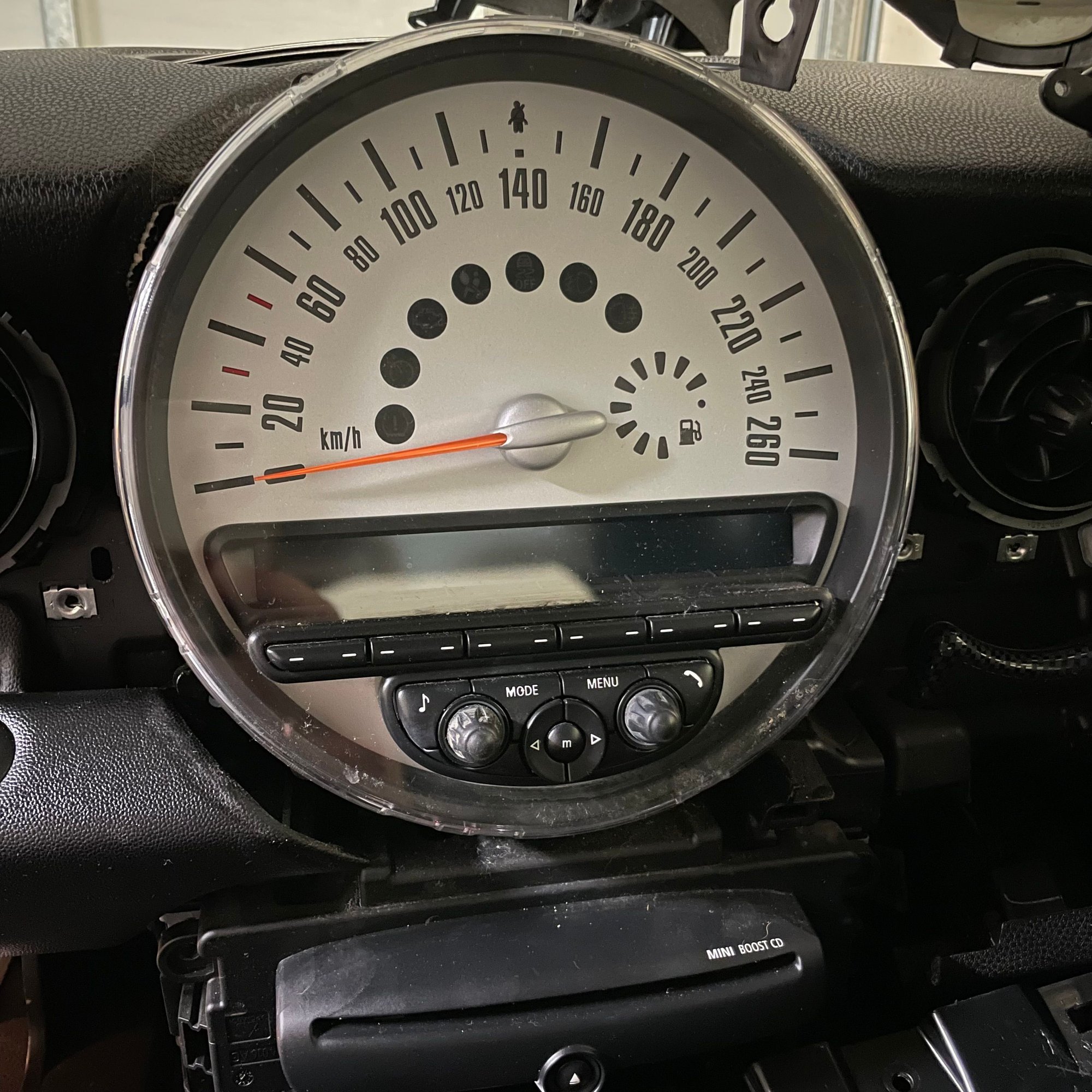

Sorry to bring up an old thread but after pulling out my radio (MINI BOOST CD), I’ve found that there are no optical connections. Does this mean that I can use an aftermarket stereo and will still get sound out?
I also have the Harman Kardon amplifier in the boot (trunk).
I’m confused because absolutely everything I’ve read on this and other forums is that I should have optical connections.
My car is a 2010 Australian spec R56 LCI.
