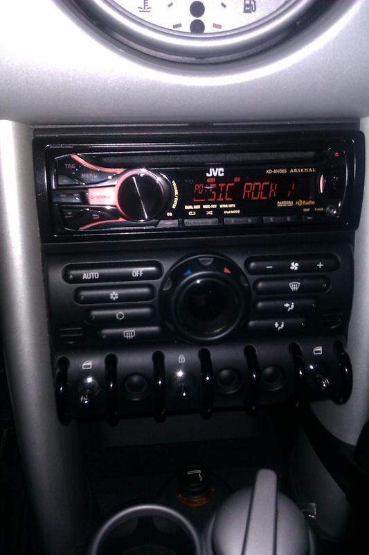

And Done
Ok, just got done with the stereo install. Works great! Steering wheel controls and all. So far, very happy with it.
Bought a JVC head unit from Crutchfield. I like that they send all the adapters and very clear instructions on how to get the radio out.
Bought an interface unit from NewMiniStuff.com. I need a JVC boost interface. Also bought an ISO connector set.
Once everything arrived I took a look at the wiring. At first I was confused because the interface did not come with any instructions. One email to Mike at NewMiniStuff and I was ready. The ISO connector is pretty straight forward. Match up the colors and you are good. The wire on the JVC for the steering wheel controls goes to the wire on the output of the NewMiniStuff interface unit.
Make sure you have a good T15 screwdriver or ratchet.
Follow the instructions from Crutchfield on how to get to the radio. It is very easy. The hardest part for me was the driver panel that had to be removed.
Once everything is out, start installing the new unit. There is not a lot of room to bend the DIN locking tabs. At first I bent them before I installed. That does not work. Install and then bend what you can. The ones on top were the only ones that worked for me.
Plug in the massive wiring harness. Install the radio. I pulled the wires so that they will be behind the driver panel that was removed. Seems to work well there.
Overall, probably took a bit over an hour. I bet I could do it again in half that time.
The steering wheel controls work well. The volume works great, no delay. The tuning up and down is "interesting". I have not figured out exactly what it is doing. Seems sometimes it is in manual mode and sometimes it tunes the presets. Still playing with it.
Bottom line. If you want to change out the OEM stereo with an aftermarket one and want to keep the steering wheel controls, I would recommend the interface units at NewMiniStuff.com. No programming, no mess, no fuss. Works right out of the box. I did not even have to splice into any wiring harnesses. I could remove all of this in 30 minutes and you would not know it was ever there.

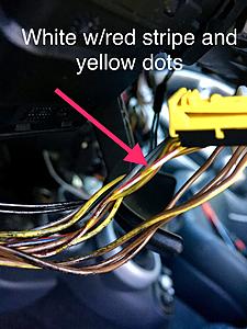

Pictures of SWI-RC Steering Wheel Interface from PAC
I realize this thread is from 4 years ago, but it left off with a request for a picture of the wire behind the steering wheel. This is the wire you need to hook up to the SWI-RC interface so you can keep the use of the steering wheel controls with your new aftermarket radio.
In this case, I used PAC's SWI-RC interface with a new JVC head unit. I had a hell of a time figuring this out and there doesn't seem to be any photos of this wire online, so hopefully this will eliminate some frustration for the group out there.
You are looking for the white/red wire with yellow dots that is coming out of the white wiring harness located on the inside bottom of your steering column. This connects to the YELLOW wire you your SWI-RC interface.
Let me know if you have any questions on this one.

I bought a SWI-RC too, but after reading the instruction I was rather discouraged that I have to go hunt for this wire at the steering column. I was just not motivated. I bought one from Newministuff in the hay days of gen 1 minute and that worked great and simple. No programming and just tap into the radio harness. Alas that worked for the Sony unit I long since obsoleted. I don't feel like paying an arm for shipping from UK for one again for my current Alpine HU.
If I understand the instruction correctly, you have to sever this white/red with yellow dot wire (from the Mini bus) and connect the yellow wire of the SWI-RC to it. This is done so the module can learn the audio commands and not to be confused with other traffics on the bus.
There are reports that the adapter can forget what it learned. Have you experience that?

restore the severed wire
I always like to read further into something. If the purpose of severing this wire from the Mini CAN (or whatever) bus is to facility SWI-RC to learn the commands, I would think I should be able to restore the severed connection once it has learned, so all the connections are done at the factory HU audio connector.
Of course if this thing has dementia the idea goes into the toilet.

Actually it's only been a few days - so thankfully, I haven't experienced any issues with the adapter "forgetting" the programming. I'll definitely report back if I do.
I agree that the instructions are intimidating. Very intimidating. However, once you know what wire it is, it's actually not that bad. Unscrew the two screws at the bottom of the steering column, pop the plastic shroud off, and it's visible - fairly easy to get to.

I think I get what you're saying - yes, you do program it (it took me a few tries to get it right, but it was my fault). To clarify: the signal from the buttons on the wheel goes through the red/white/yellow wire to the SWI-RC and then, there's a wire from the SWI-RC that goes to a special input on the back of the new head unit that is separate from the main wiring harness behind the radio. If you sever that red/white/yellow wire connection behind the steering wheel once it has learned, the SWI-RC will not receive a signal when you press any audio buttons on the steering wheel.
Crossing my fingers that my particular SWI-RC does not get dementia.

The two wires that you connect the SWI-RC to the stock HU connector are power and ground. The red/white with yellow dot is the command bus from the MFSW audio control. It joins into a multi-function multiplexed bus which includes other functionality. Unlike the Newministuff module that comes purpose-design for the Mini's MFSW it need to learn in a "clean" environment. This is why you have to sever this wire from the bus so the SWI-RC can learn in the absence of other data payload that we have no control of. Thus is the price of cheaper general purpose MFSW like SWI-RC.
Your photos help me as I didn't care to dive into the foot well to find a specific wire to cut and splice into. Hell, I might just break up an oscilloscope to see what stuffs are on the bus.

My plan was to see if I can get the SWI-RC to learn, and hope it can deal with the Mini CAN bus at the HU connector. Unfortunately the the rigid timings on how you have to initiate the learning process, I was unsuccessful.
I am still not keen on dropping the lower steering cover to access that wire. While I failed, what didn't kill me made me stronger.
