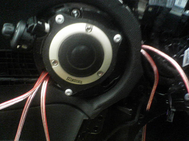

i just traced the old midrange bracket and cut a circle out with a hole saw...
sorry for the low tech approach
Attached Thumbnails Tweeter Adapter Plate-0729091251b.jpg   Tweeter Adapter Plate-0729091515a.jpg

I will ad mit that the 2 longest parts of putting the front speakers in where fabricating the tweeter plate and figuring out where to put the crossovers.
PS..i was not in anyway trying to knock your drawing...if i had had that on Saturday i would have used it for sure
