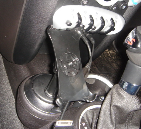

Hi All:
Just took delivery of my Clubman S two weeks ago and knew I would want an iphone cradle option. I am using the comfort bluetooth along with USB connection to route calls and address book to the Mini and also listen to tunes from my iphone.
I looked at the proclip and other options and then ended up purchasing the kit from Griffin found here.
http://www.griffintechnology.com/products/windowseat
The benefits of the kit are: it looks fairly stock; not-too-tacky and comes with several clips which are molded to perfectly fit any of the iphone, iphone 3g or itouch. Lastly, the clip/device plate rotates so it can be viewed vertically or horizontally.
Installation:
I tried using the included suction mount by modifying the included smooth plastic disk and adhering it to the bottom of one of my cup holders. That worked for a week until the temps started to fluctuate and then suction would give way intermittently.
Finally, I took the astray we all get with our Mini's (which would have gone into a drawer somewhere since I don't smoke) which fits the cup-holder snugly. Using a Dremel tool, I bored a hole into the lid of the ashtray which was just large enough to thread the neck of the Griffin holder into. The fit was very tight and allowed me to just pop the ashtray into either of the two cup-holders, connect the USB/Ipod cable and adjust the angle of my phone so I get to see the face of it as I drive. Perfect for NAV too. Pics attached.
Hope that helps any of you looking for a good place to put your iphone!

You can make a platform for the cup holder with a 2" black plastic pie coupling, and a disk cut from plexiglass, or some other material. I turned black plex, and various hardwood disks on my lathe.
